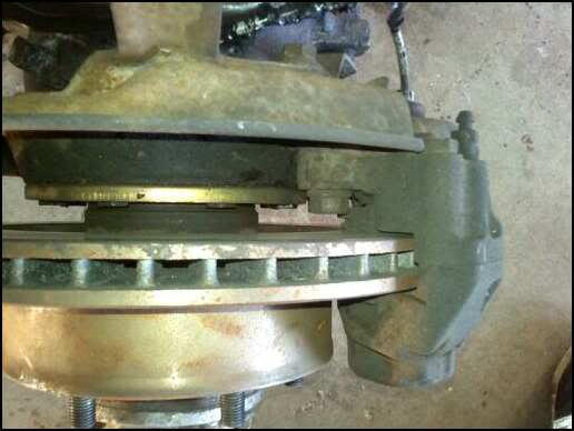

in summery, if you machine down the the outer edge of the WMS, you might be able to throw on a Tacoma rotor and use a IFS caliper...
This will make changing a Birfield and a rotor a snap!

What am I looking at here? Which hub/rotor is that? And by machining down the wheel mounting surface you mean... On the hub or rotor in that case?

a few more questions.... What lugs are those? And what does this do for width? I think I still would need wheel spacers. What would that do bolted to the outside of those rotors? They look to be a little loose around the lugs also...do they wiggly any, is that normal?

they are free floating rotors, so they will look like they are loose. they are designed to move laterally on the hub. this helps them line up with the brake pad better when the brakes are applied, ensuring a better braking surface.

SAS on a 1987 4runner, the axle I got is out of a 1980 model though. I see what your saying about the floating part but, once the wheel is bolted on its not moving anymore... I was saying it looks like it could rotate just a hair back on forth on those lugs is all. I'm still wondering my questions from earlier though. As far as width and lug length. I'm going to check on the taco rotors, I'm just wondering about the wheel spacers on the outside of them...
