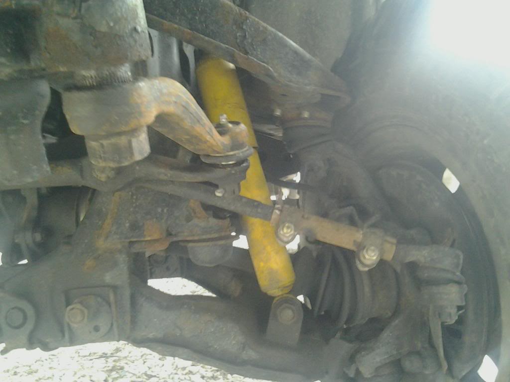

I installed bj spacers on my '93 T100 a few weeks ago, i used the shock "extenders" included in the kit and got new shocks, after a few days my shock broke, it was a cheap shock so i put my old shock back on and that one broke after 2 days! both on the right side, the left shock is perfectly fine. when the shock broke it basically just stripped it out so i could pull the two ends apart.
Any ideas on why this happens? need more shims?
Im saving up to get better, longer shocks but i dont want to break those also.

Thats what im confused about! i havent even left the pavement. The shocks were the same as eachother and the same as the old ones. and with the shock extenders my shocks were barely shorter than full extension. they always break and then bow outwards towards the tire, i can post a pic tomorrow, i left it on... atleast i can pretend to have a shock...

on level ground, my suspension only compresses about an inch from full extension, with or without shocks. im not sure if the owner before me cranked the T bars or not, i loosened them a turn and a half when i installed the spacers, which didnt make a noticable difference.

my phone likes to take randomly sized pictures.
