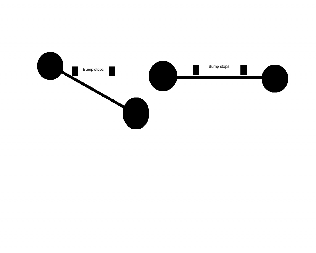

And articulate it fully in a dich or ramp. And take measurments off the frame, then compare to your flat bed build. SCToy has good advice, but the tire can still go higher when articulating then it can under level suspension compression.
Its time for a cave man drawing to explain

Old Mar 31, 2013 | 05:10 PM
SCToy's Avatar
Joined: Oct 2009
Posts: 1,560
From: Santa Cruz, CA
Good thinkin thatguy!
