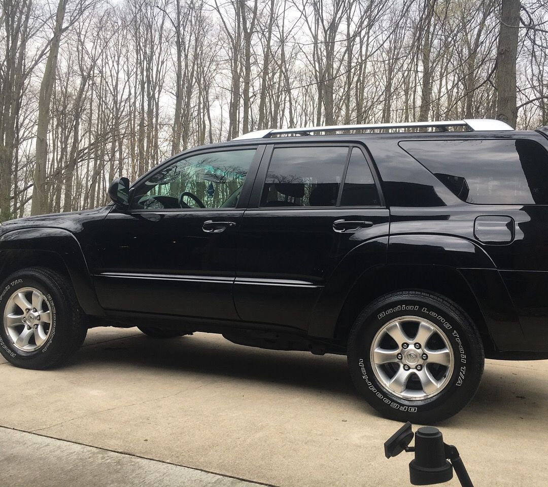

The first order of business was to take the god awful side steps and mud flaps off. The previous owner was sad to let it go, but he assured me he was getting a new gx470 to replace it.
When I got home I detailed it, debadged the whole thing and greased all the ujoints.

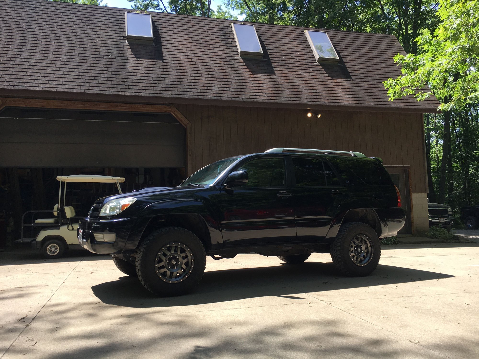

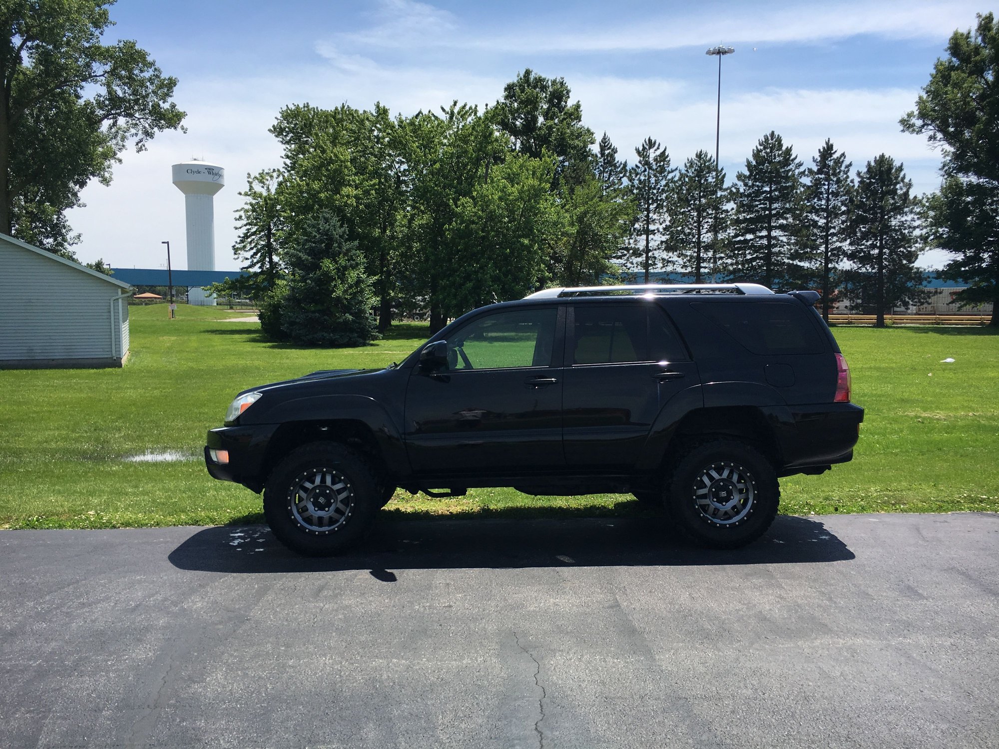

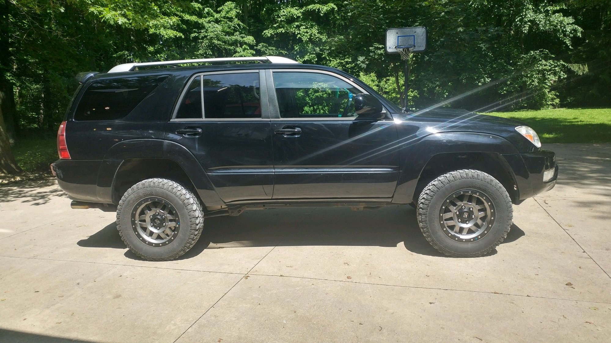

The first mod was to get rid of the ugly sport wheels and stock size all terrains. I got a sweet deal on some brand new XD 128 Machetes in matte grey. I also sourced some 50-60 percent 32/10.5 BFG Mud Terrains off of a friends Rubicon for cheap.
this is what they look like mounted on the new wheels and here they are on the 4runner at stock height.

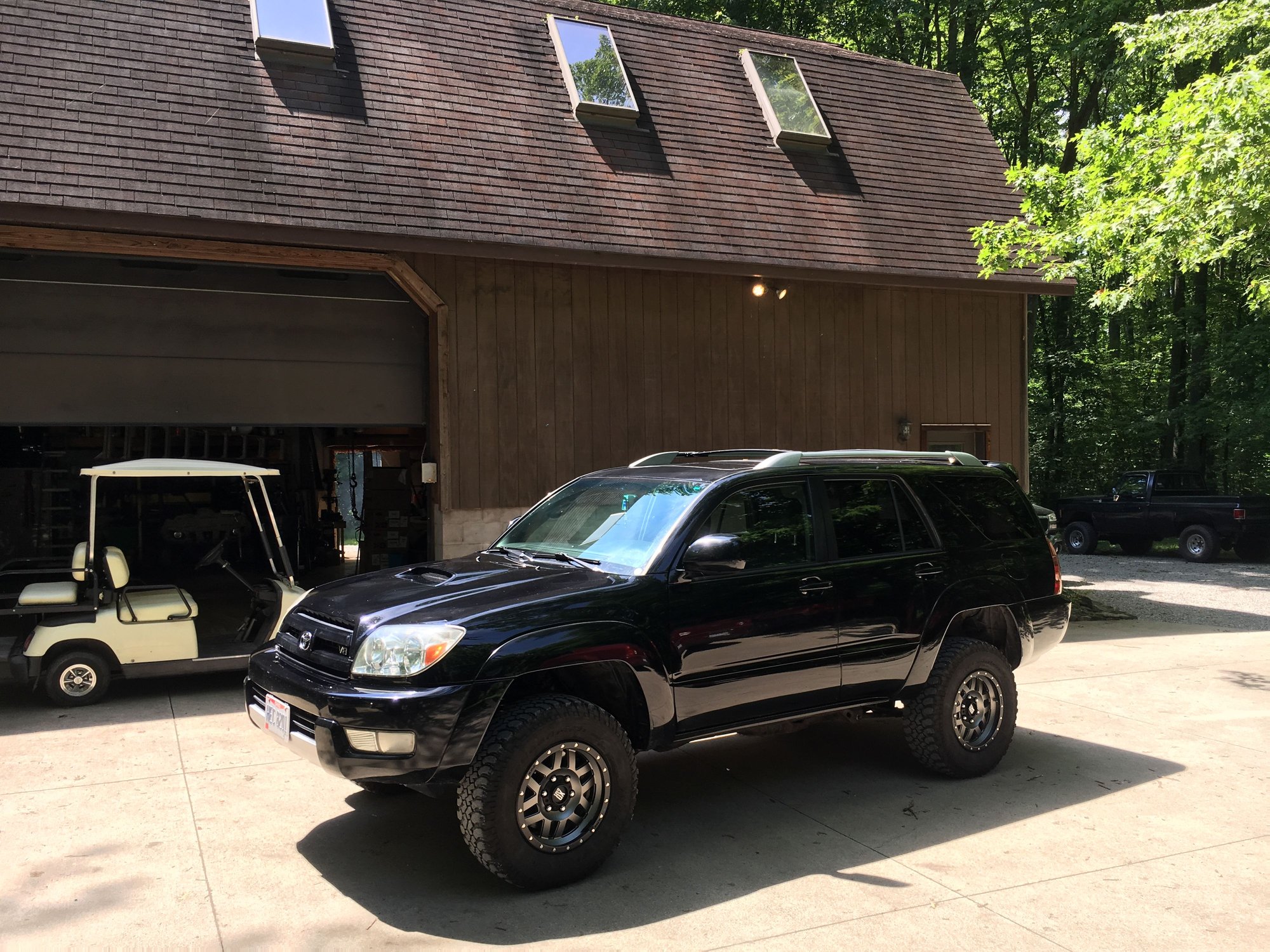

My lift kit came in I decided on the SR 2inch front spacer and rear 2.5 SDT spacer. The install finished product looked like this.

Cleaned it up and got it aligned. Really loving this thing

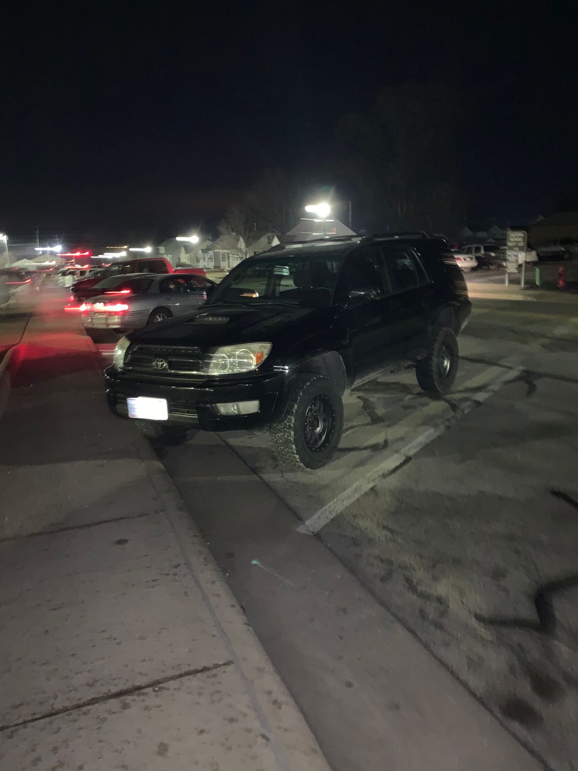

Well it was put all back together and there was a terrible howling from the rear end. Somehow the pinion crush sleeve was damaged and the pinion depth was all out of wack. So I had to pull it all back apart and that is where we stand as of today. I also got a two post lift so expect to see many more updates and it’s actually enjoyable to work on my 4runner and other vehicles
How it sits after the colormatch and other mods
Up on the lift pre disassembly, pulling the third member out is now a 2 hour job instead of 4-5

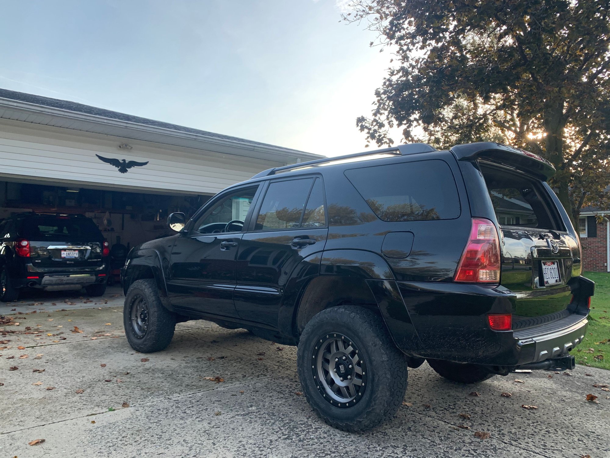

Well I sold the 4runner about a month back, here is some pictures of it in its in so form. Ended up buying a new one, and then getting. 3rd gen you check out on my build thread “jaretstuffs 1999 highlander”
