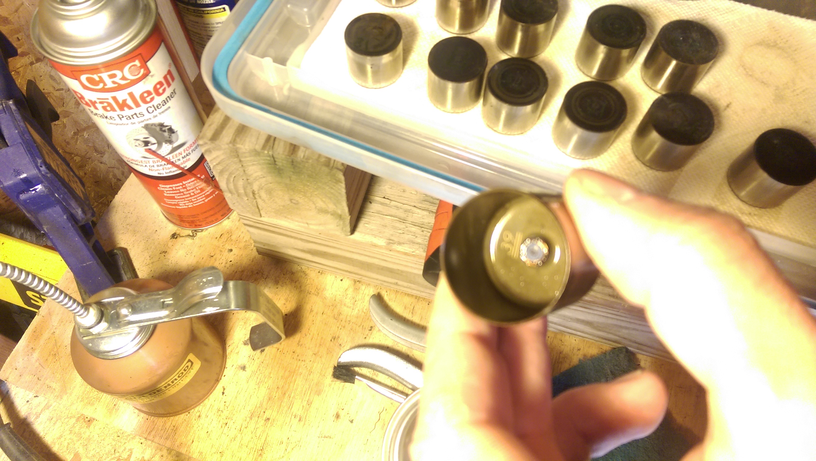

A few weeks ago, I decided to rebuild the 1GR-FE engine on my 2nd generation Tacoma after I determined that my head gaskets were friend after a few overheating mishaps. I did understand the complexity and tedium of the job but proceeded anyway looking forward to the technical challenge and the learning experience.
For the most part, it has gone well, I have cleaned and polished every square millimeter of the heads, lapped valves, made sure there is no warpage, you name it, I did it. I have also reinstalled the heads back on the block, with new gaskets and torqued them to spec. One mistake I did, however, was that when I initially disassembled the heads, after taking the camshafts out, I didn't know that the order of valve lifters was relevant and I didn't mark it down.
I did, however, separate the left from right side of the engine. So I have two sets of 12 lifters each that I need to redistribute in their old/new places. Ideally, they would each go in the exact same old place it was before but I think that matters less considering that I lapped my valves, which would introduce irregularities so the gaps would vary, making it unlikely that the old order will now fit.
One thing that may be helpful is that each of my lifters has a size inscribed inside it (the one in the picture is 39, can't be seen very well).
Here is the distribution of sizes on the left side of my engine:
I understand, according to my Haynes manual, the lifters have to be on the valves in some initial order and the camshafts and the timing chain need to be on. The manual says put piston 1 [I think the right side, the one closest to the front (radiator)] in TDC, then measure 8 specific valves (manual has a diagram which ones), then spin the crank 2/3 turn and do the same for another specific set of 8, then repeat one more time. I will also need to use a micrometer to remeasure the actual thickness of each lifter because it may have varied over time from what it says it is on it.
Here is what I was thinking: Use a set of baseline thinnest clearance lifters to do the measurement, to make sure none will be too thick during the trials. Then measure the clearance for each. Then do the computation how much I really need for each valve based on the minimum. Because, I was afraid if I do the same thing with the existing set, some thicker lifters may end up under cams that can't take that thick a lifter. Of course, I would need to acquire a set of 24 lowest thickness lifters for this measurement but what are my other options ?
Or can I measure the clearance without the lifters ?
Alternatively, does anybody have a specification or diagram for default clearance per lifter that I could use for this initial arrangement before I measure ?
- 39 x 3
- 46 x 2
- 38 x 2
- 45 x 1
- 43 x 1
- 41 x 1
- 40 x 1
- 37 x 1
