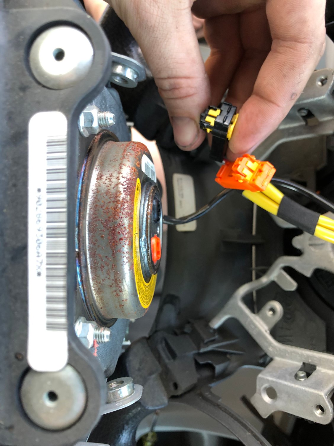

loosen the two torque head screws on either side of the wheel, this will allow removal of the airbag.
remove the two wires from the back of the airbag by pulling out of the yellow tabs, and pulling straight back on the connectors.

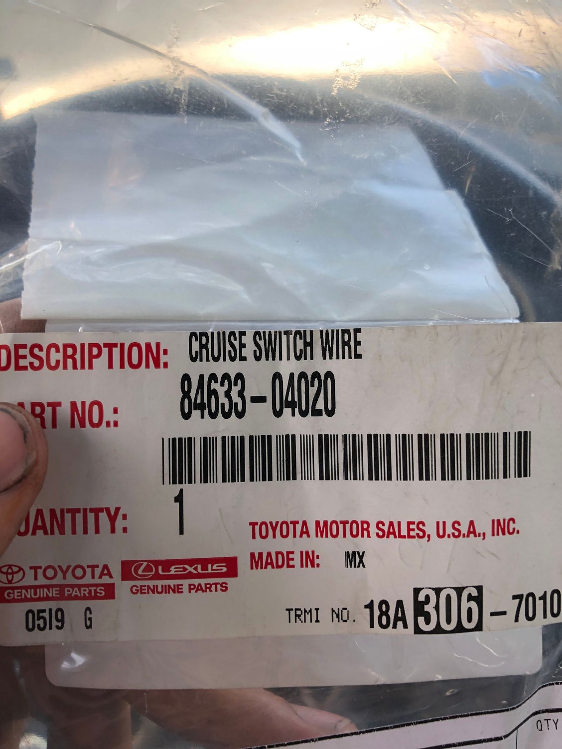

this is a PN for the new ground wire. simply remove the existing wire, and replace it with the new one which has an extra wire for the control stick.

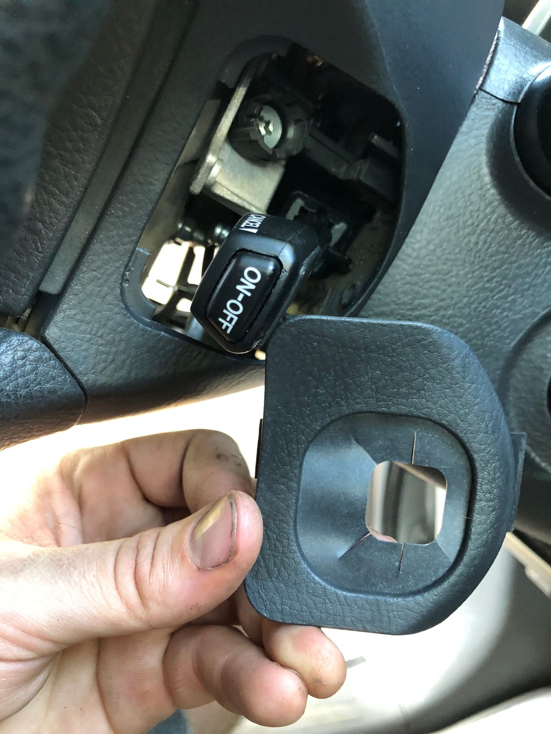

install the control stick like this

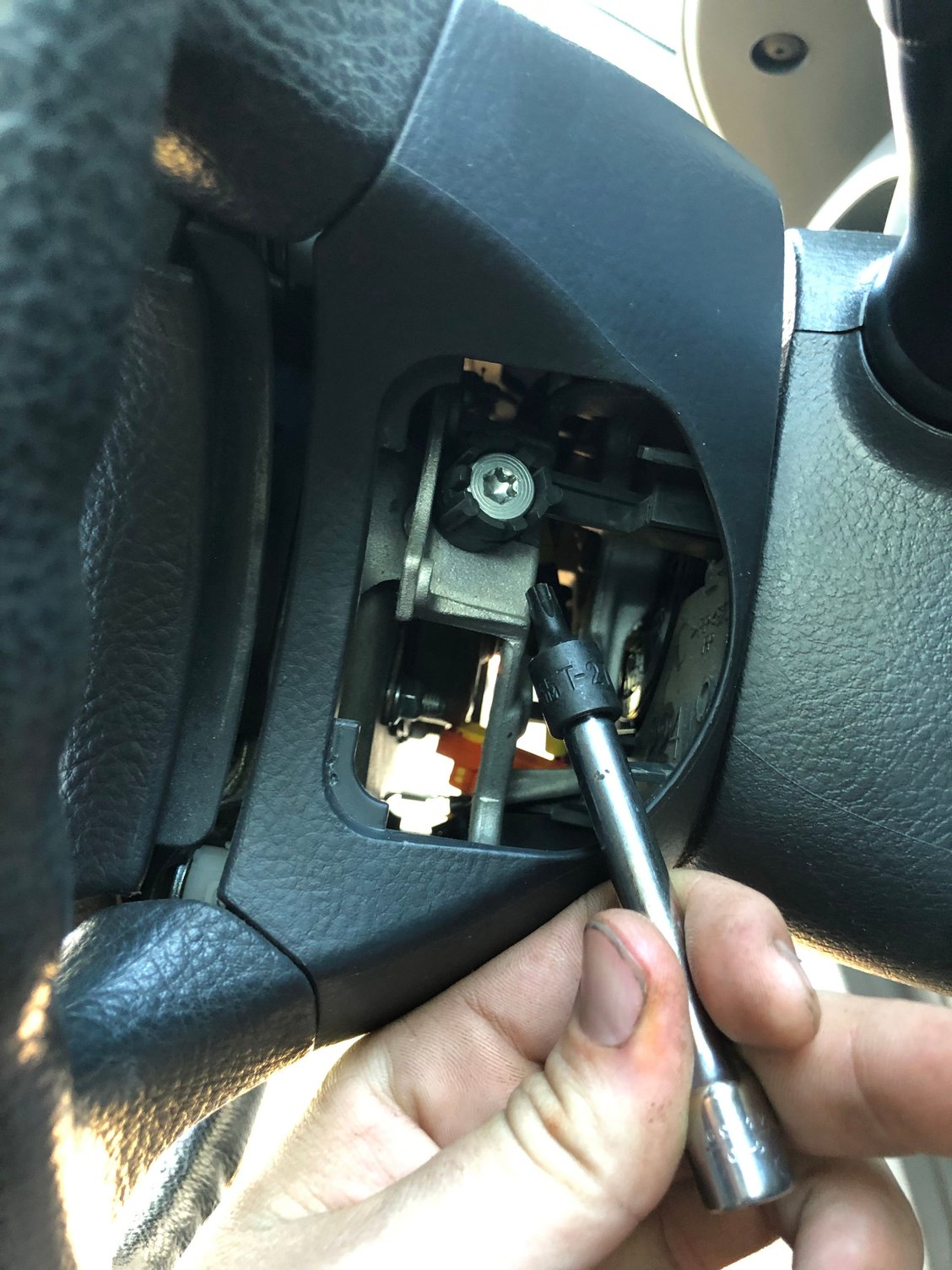

these are the screws you will need, there are two
install the new bezel

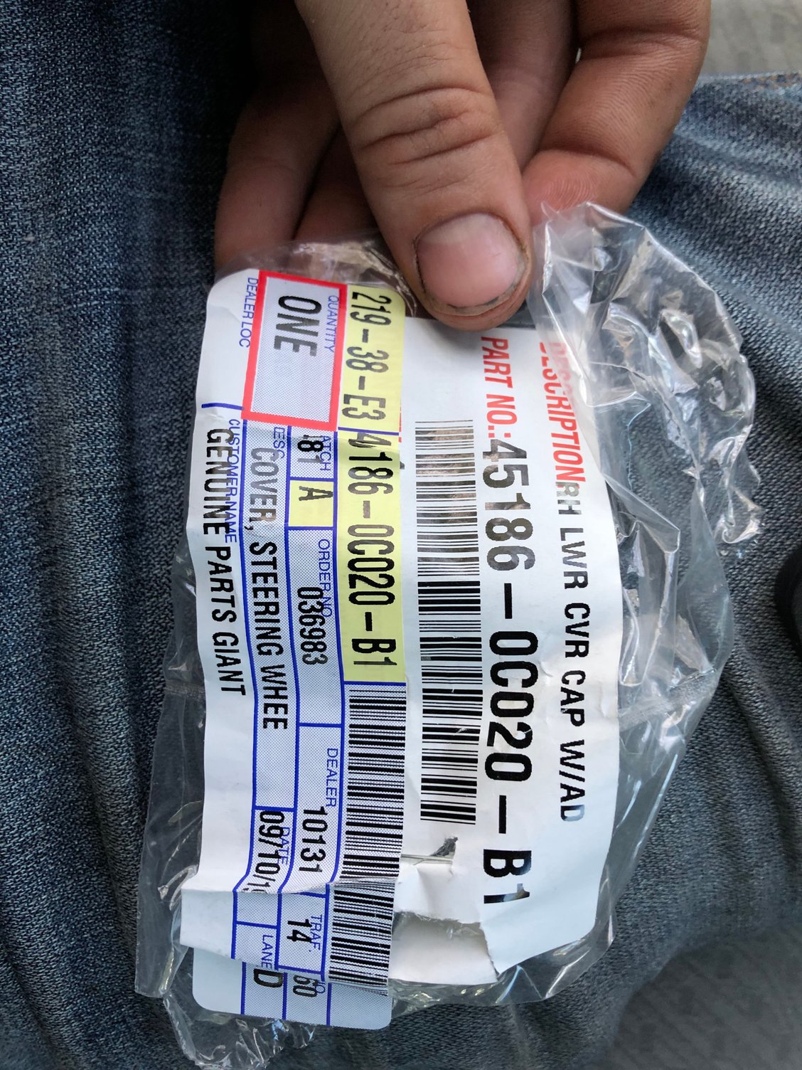

this is the bezel PN

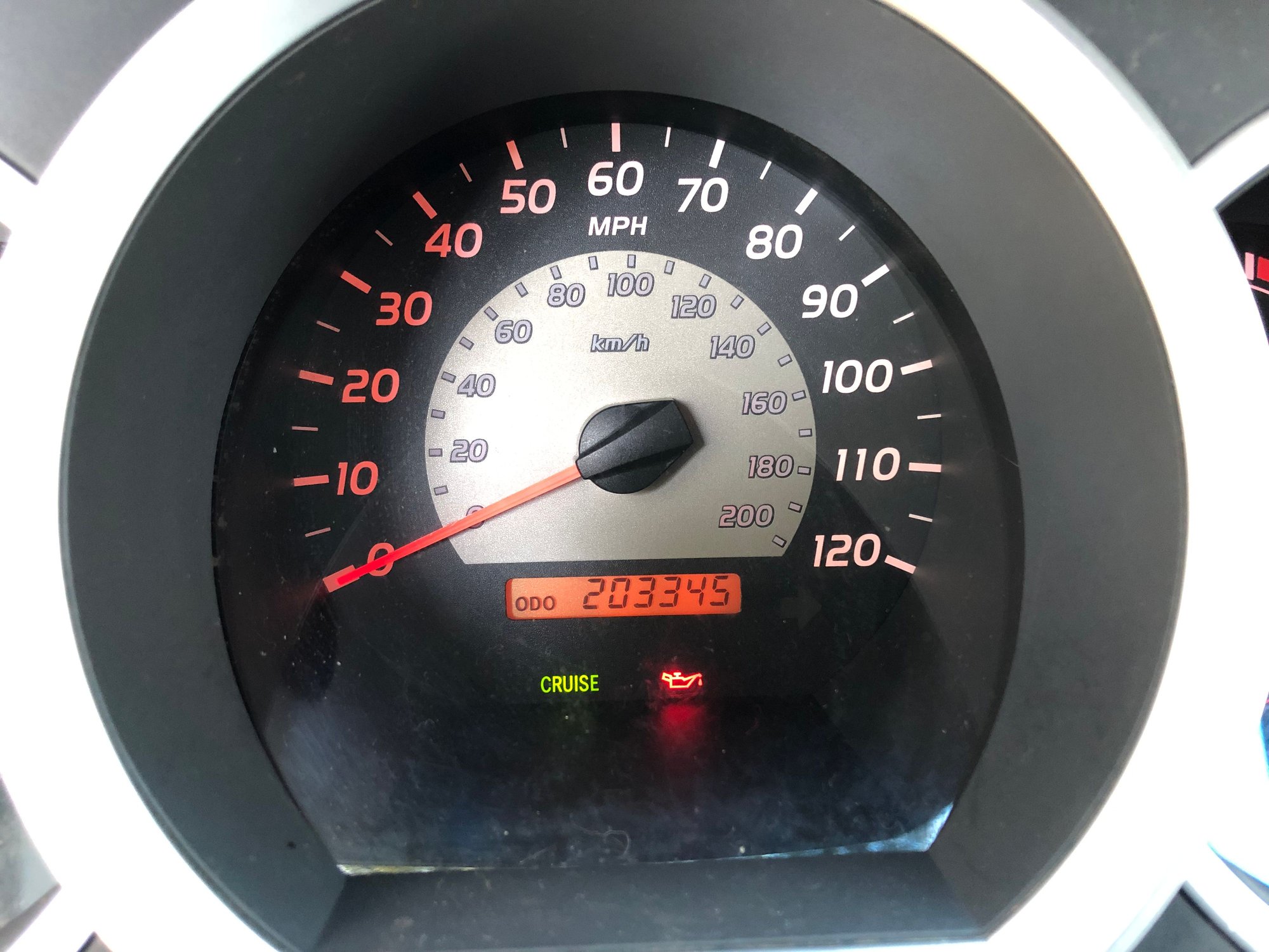

after installing the airbag, check to ensure your control stick works. bam, you have cruise control.
