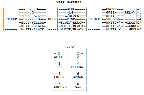

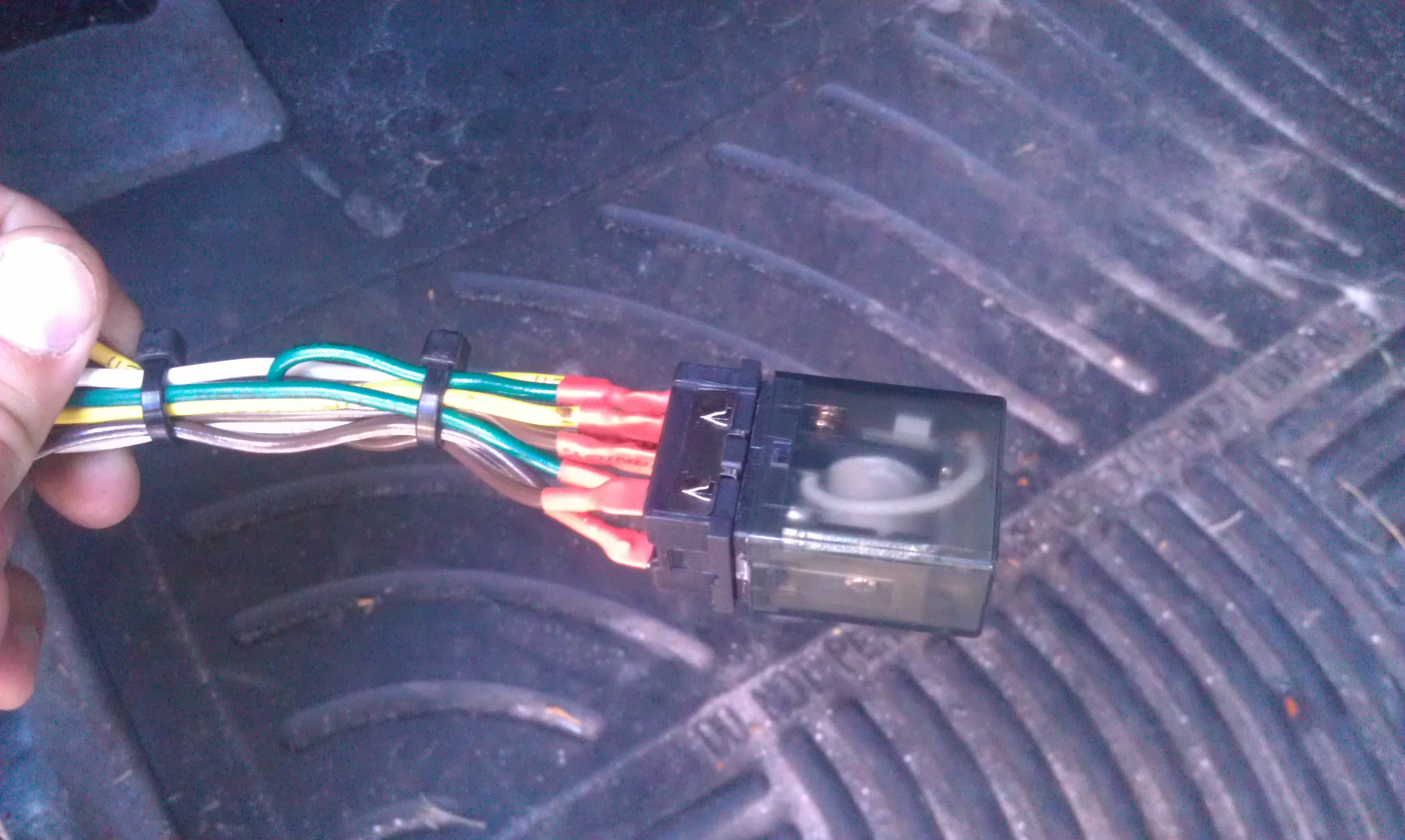

Sure did! My stupid self swapped two wires around when soldering to the relay socket Swapped the wires around, and presto, locks and unlocks like it should! Adjusted the brakes out, bled them one more time just to be certain, and everything is buttoned up and in perfect working order now!

I used trailer wiring for the harness I made; just easier to route the wires when they stick together. After I laid this little schematic out, it was super easy to see my mistake, lol
