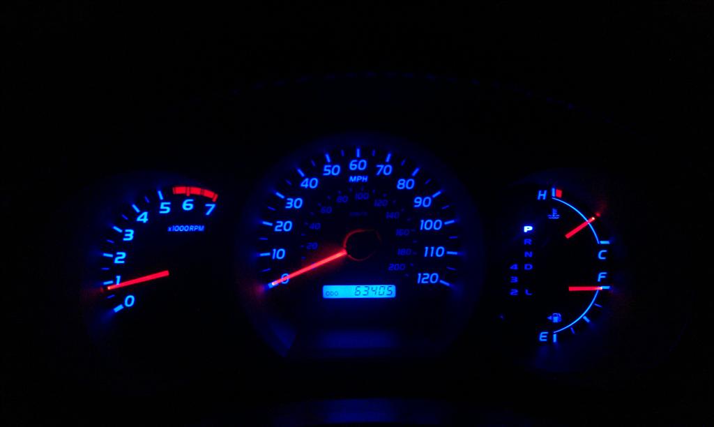

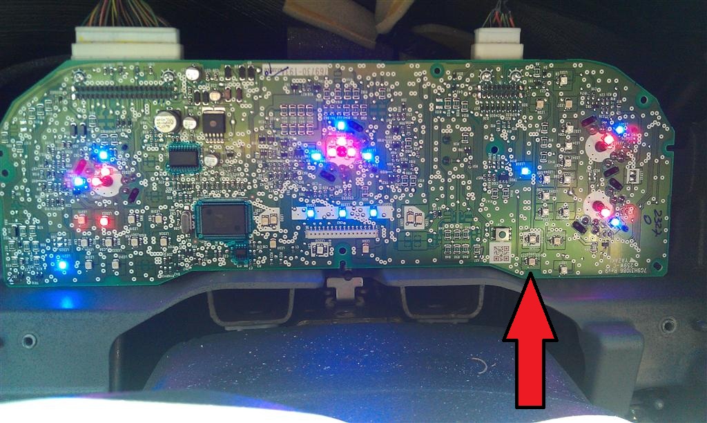

That is a fantastic question... I'll bring a multimeter to work with me tomorrow and pull a cluster apart and see if I can't track down the wire that leads to turning the diff lock LED indicator on, assuming it would be that simple. That would be awesome because then I would just have to make it get power when the button is engaged. Otherwise I'm going to have to get really creative, lol
interesting thing is, Toyota must use the same cluster no mater how equipped, because my original cluster has the LED's in place for the 4wd indicators, and most importantly the locker indicator. I just double checked by looking at some old photos of when I pulled the cluster apart and changed the LED's over to blue ones

that change over turned out fantastically by the way; still loving the look of it

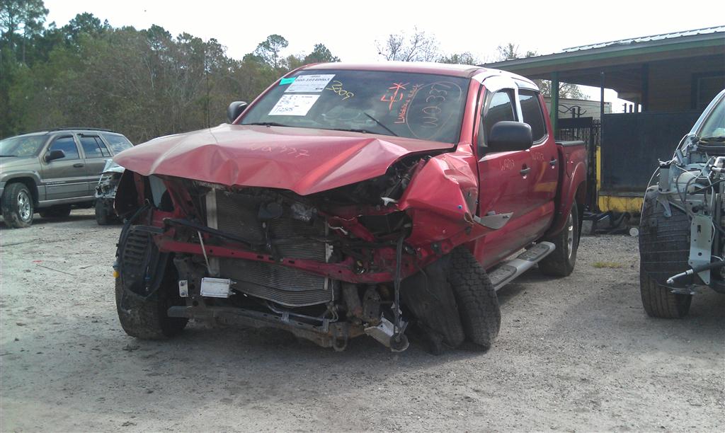

Made the deal today; I'll be bringing home the complete axle and the wiring harness for it Friday, the axle's going in this weekend, and I'll bring my original one back to them Monday! May or may not get the electronics worked out over the weekend, but I will at least have the axle under the truck
Here's the donor vehicle; an 06 Prerunner TRD. Took a serious hit to the front left... I'm also getting the TRD floor mats out of it, just 'cause
