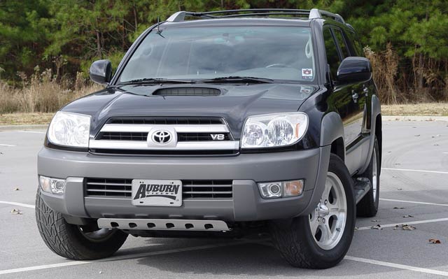

Of course I saved the best for last.....
Keep in mind, this is just for looks. Since I rarely go off-road, that is all I wanted. I feel quite certain it would be ripped to shreds on any kind of rocks..
Also, keep in mind I have no welding stuff, and just made due with what I had. I am sure some of you guys that have welders and such could make much better stuff, but I still had a good time.
fourunnabilly gets full credit for me even trying this. Thanks buddy!!

Momo-
Hey, way to go...looks great. Killer works on the brackets and mounting setup...looks perfect, I may have to copy you now! The new shot of your rig looks sweet as well...those are 18's you are running, right? Real nice. Hey man, I deserve no credit what so ever...all I did was tell it could be done, and you found an even better way than I did. I gotta get me one of the sport edition hoods...we are going to open it and make it functional just to help cool the engine compartment once the blower goes on, since it obviously would be bout' impossible to create a "ram air" setup. Again, way to stick with it and get her completed. So, now I can just say "talk to momo, I don't have a frickin clue on how to mount it?" Peace.

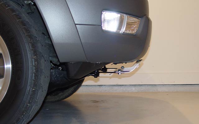

Hey, could you get a pic from the side for me so I can see how far forward the plate goes, that will help me a ton when I get some time to remount it.

Yep, they are 18" Enkei's. I really like 'em being different from the stock rims.
Here is a shot from the side. I has started raining here so I had to shoot it in my garage.

Hey, that is a perfect pic, again damn nice work...looks completely OEM. I am definitely gonna copy your setup now. Just a thought that came to mind when looking at your rig is the black "cups" that are under the front bumper on both sides. After I trimmed mine, though it is just a subtle detail, it really cleans up the front end from both the front and side, all they truly do is collect dirt and rocks. If you take your time when trimming, you would never even know it was done...I'm not sure if I have a pick of mine as a close up...I'll check. Anyway, just an idea. Keep up the good work...I'd even suggest putting your custom fab job in as a tech write up, I guarantee a ton of people would do the mod if they had some guidance...or maybe we just keep it our secret??lol...nah, definitely not how it works around here. Sweet work.

Just a friendly suggestion as that my was concern when I saw it

Billy I do hope that you don't forget that using that front skid, you will definitely lose a tow anchor point in the front. (i.e. if you get stuck then ur screwed).

I guess you hadn't really read through this thread yet. I have the skid plate installed and even made some brackets to hold it out a little further like the 3rd gens have.

It all depends on your driving. If you are doing some mild off-roading, I would think it would be ok. Keep in mind (at least for my truck) it is just for looks. The brackets I made are strong but would hold up to any serious pounding.
It will also depend on what you brush guard looks like and how it is mounted. There is a guy on toyota-4runner.org that is putting on a bull bar and is going to put the skid plate on as well, so you could wait and see how his looks before you decide. If you go there and do a search for "loyd" you will find his posts.

1. The skid plate is pure asthetics only...Good Times made a very good point that you do lose your tow eyes on the front, but if you were to get stuck, you could still definitely hook up to them...but I woulnd't bet that the skid plate would come out looking the same.
