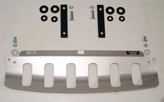

Here we go.....screw the work. I wanted to get this done and let you see it.
In this first pic you will see all the parts I used. for the bolts that go through the tow hooks, I used 1/2" x 2" bolts, along with the standard 1/2" washers. Since the 1/2" washers are too small and would pull through the tow hook, I placed a larger washer on either side of the hook. I painted all the washers for the tow hook end before I installed.
The metal strip was about 1 1/2" wide and about 1/4" thick. I got it at Home Depot in a four foot section. The crappy part was cutting it with a hack saw. I cut it to 8" sections and drilled 1/2" holes.
The bolts are 1/2" by 1 1/2" but I ended up cuting them down to 1" so there wouldn't be any sticking out the top.
