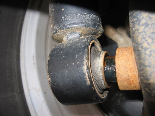

OK, my relocs are out, and now I understand some of the problems that were already obvious to everybody else (especially Lance ). Here are a few pictures.
In #1, this is looking at the left rear tire from under the spare. The shock is mounted on the reloc, and below is the original mount. Notice that the angle of the reloc mount is noticably wrong: it points up with respect to the original mount. This puts strain on the shock bushing.

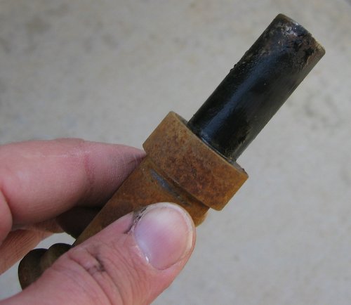

In #2, notice the fluid on the reloc after removal. This evaporated quickly, and I have no idea what it was. Smelled like hydraulic, but I didn't find any obvious leaks. I'm also quite impressed with the healthy coat of rust after just a few months.
In #3 (this is the right side now), I've started backing the shock off the reloc, and you can see the mysterious fluid and the wrinkling on the bushng from the angle error if you look close. Now that I'm back on my original mounts the bushing appears normal, so I guess I got to it in time.
Anybody want some rusted, defective toilet paper holders?

glad you got to it in time ... since you didn't find any fluid leaking on the shock itself, you should be okay, i'd think.
thanks for posting the pics.
Yeah, I noticed an inordinate amount of rust on mine too, and this is in Arizona where 40 year old vehicles have little rust!

mine rusted within a few days. i figured it was just because i hadn't painted them before installation.
