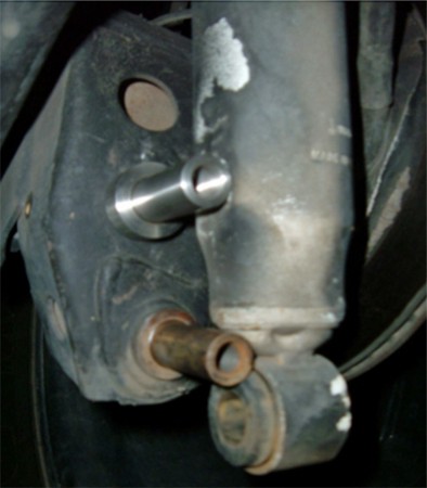

However slight the variation of angle is, keep in mind that the distance measured off the original line between the two shock mounts will increase the further away a measurement is taken from the bottom shock mount. I was always wondering why the bottom of the shock was so beat up and/or spray-painted. Maybe because they had to beat the thing on with a hammer to overcome the change of angle.

That lower bushing angle is totally wrong. I think I see what has happend here. Same thing that happened to me in 2001 with the FZJ-80 rear shocks. Drop was great, but the drive shaft hit the gas tank, and at full compression I over compressed the shocks and the seals blew out and leaked oil. To fix this I came up with the droped bumpstops. In the end I could not get the FJ shocks to work correclty. I went back to a 4Runner shock.
Same thing here, although the lower angle of that bushing is not so hot, the shocks were more than likey over comressed, blew the seals and are now leaking.
If you move the lower mount up, you need to move the upper mount as well or get a shock with a shorter compression number.
All in all, this did not work for me in 2001 and it's not going to work for Tony Baloney in 2005. Droping the bumpstops would help but then you will so little up travel left, what will be left in the end will be worhtless.
So the 3rd Gen rear bumo stops I originally built, I threw away the original adapters and made some new ones that just swaped out the crummy stock bumpers with the nice poly ones.
Actually, moving the shock onto the reloc spindle was easy and did not require any pounding, etc.
Here's the photo I was talking about, posted by Lemke on t4r,org, he says its a photo he collected, but isn't his runner. Maybe the shock damage was caused by wheeling, but I thought perhaps it's installation was "persuaded" with a hammer.
Attached Thumbnails 4Runner lift: Rear X-REAS relocation-lift2.jpg

I think most people had to hammer/rubber mallet them on.
