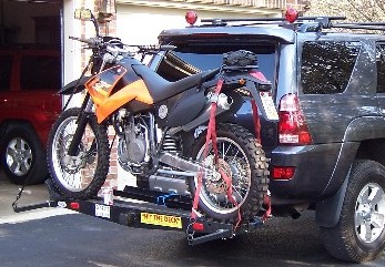

I haul my KTM with a Versa Hauler - the type that slips into the reciever and hangs across the back. 1st I added some Airlift 1000 then went to an OME 3 in heavy duty spring. The air bag was fine and worked great I just like the look of it a bit taller int he back. When I added the springs I cut 1.5 inches of the spacer for about 4 inches or so of lift in the back.
