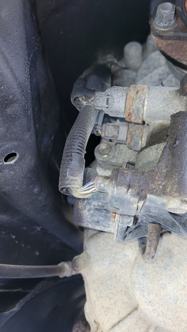

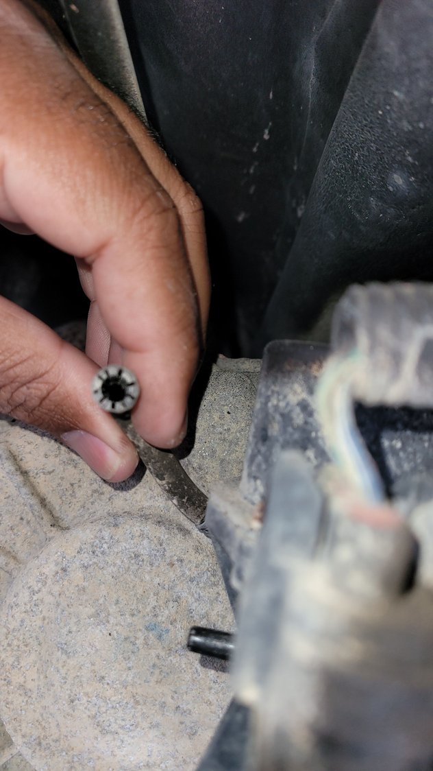

So I've moved back to the 4wd actuator. Found a bad vacuum line (photo) but that didn't fix it. I want to try these sensors maybe. But can't find the part number.
