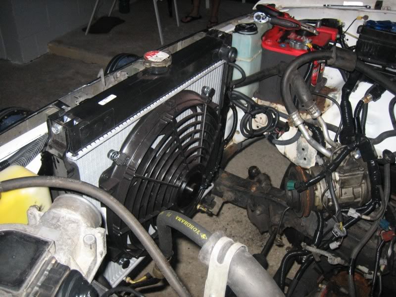

It is in fact a serpentine driven pump; the fan clutch is bolted right to it and driven on the same pulley. Which brings up another opportunity for upgrade, and electric fan, but we'll see how funds are looking at that point. Doesn't really need it, but might get a little more MPG and would just be less strain on the motor without the mechanical fan. I wouldn't expect the gains like I got on my 22re in my 91 when I did it, but it would certainly help; if anything, it'll be less noisy.

That's an interesting idea; never heard of using a capacitor for the fans, but that does make since. With the single 18" fan I had on the old 91, the headlights would dim and the engine would seem to strain for a second when the fan kicked on.
I went with just a universal aftermarket fan and a stand alone temp activated switch (as well as a 3 position override switch in the cab) when I did the 91, but considering where I work now (a scrap yard ) I'll keep an eye out for something that may be a good fit.
