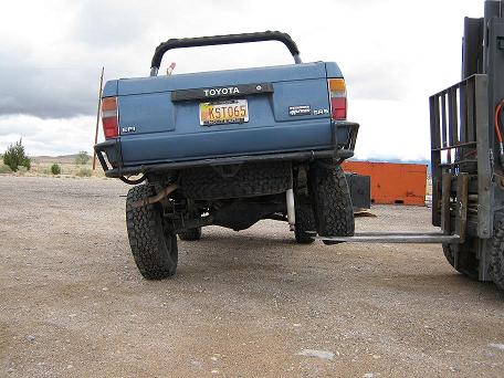

That is the truth. The ride is incredible but there isn't any huge amount of flex. I will say that it does flex more since the leaf pack has more than 3" to travel before it hits the bump stop.
Pics.
Attached Thumbnails Zuk Mod options and opinions with pics-truck-mods-061.jpg   Zuk Mod options and opinions with pics-wheeling-024.jpg
