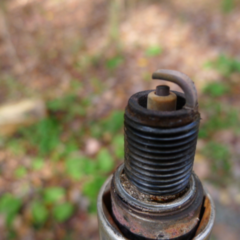

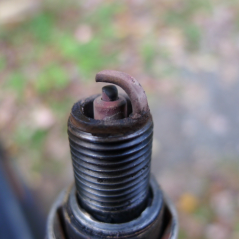

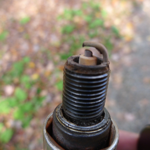

Hmmm, on second thought, maybe #2 cylinder plug is a little different. It's a slow leak. Numbers 1, 2 , 3 in that order
Attached Thumbnails Your 22RE Timing Chain Mileage?-p1010925.jpg   Your 22RE Timing Chain Mileage?-p1010926.jpg   Your 22RE Timing Chain Mileage?-p1010927.jpg

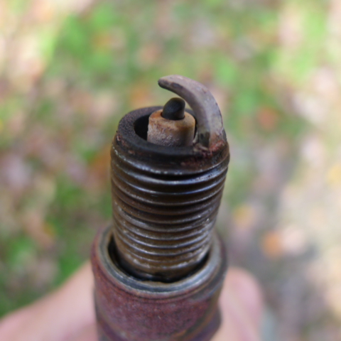

here is number 4
