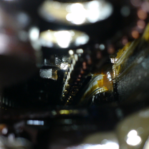

Valve cover removed
You can see some light marks on the inside of the head. There is plenty of slack in the chain on the right side although not from wear but a missing guide.

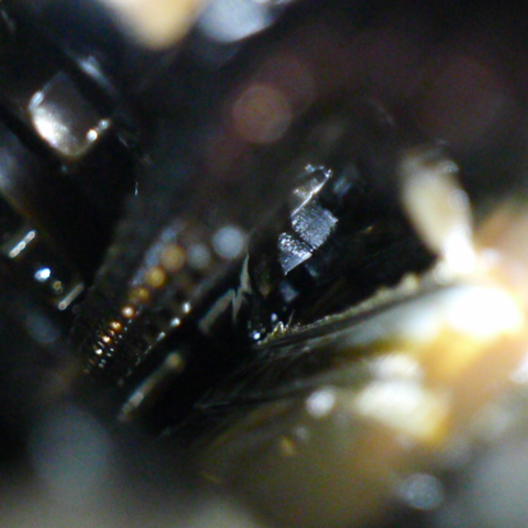

Groovy and Broken Guide
Here you can clearly see the grooves! In the second image you may be able to make out the side of the broken guide (black plastic).
