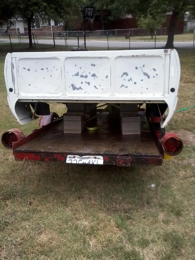

I have hauled many beds with my trailer. I stick some concrete blocks on the trailer and I have enough tie down points on my trailer and enough on a truck bed to haul safely down the highway at highway speeds. This shows how I do it.
