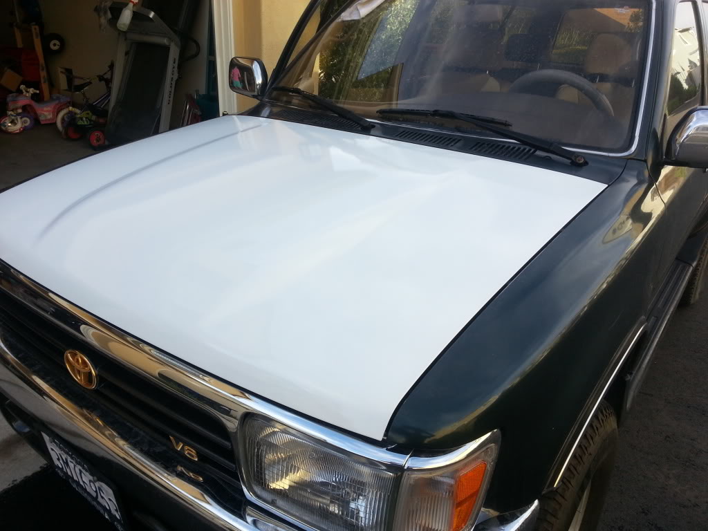

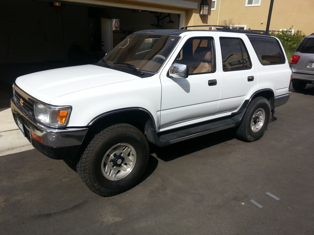

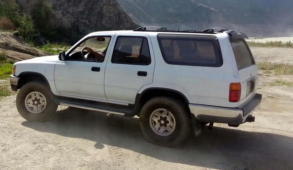

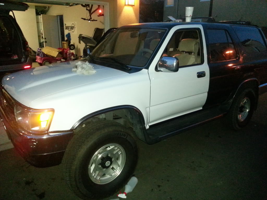

Just wrapped my 4runner looks pretty good. But the thing that I'm most Surprised about is the durability of the vinyl wrap while offroading. I've been on 4 trips so far. The usual IFS type a trips..... nothing hardcore, but as much mud as the truck can handle, rocks, dust and branches were all involved though. The wrap is holding up rather well. The material was just under $400 and I installed it. The finish is much much smoother and even than a rattle can job and the shine is better than a MAACO type of fish eyed job. If anyone wants to try it I can help with advice on installation or prep.

I Used Hexis brand Vinyl. It can be found on Ebay all day long for cheap. 3M is much better and easier to work with. I chose the cheapie route though. For the prep I'd suggest taking off any molding, lights, racks etc... You get a much much better install result. You can tuck the vinyl better into the recessed spots and will look much cleaner. This also allows you to change the color of your molding while its off if desired. I did the door handles and chrome around the fenders in black. I used plastidip on one side and vinyl on the other side. I again prefer the vinyl. Just my opinion of course. The clear coat was shot as with most other 2nd Gen Yotas. I sanded it smooth. Just the clear and not going all the way down to bare metal so the vinyl looks smooth too. nothing major just hit it with 400 sand paper. Wash it thouroughly with dish soap to get any left over grease and grime off. Then wipe it clean again with rubbing alcohol. That promotes great adhesion when the vinyl is set for a couple of days. The better you prep the easier and cleaner the insatall goes.
