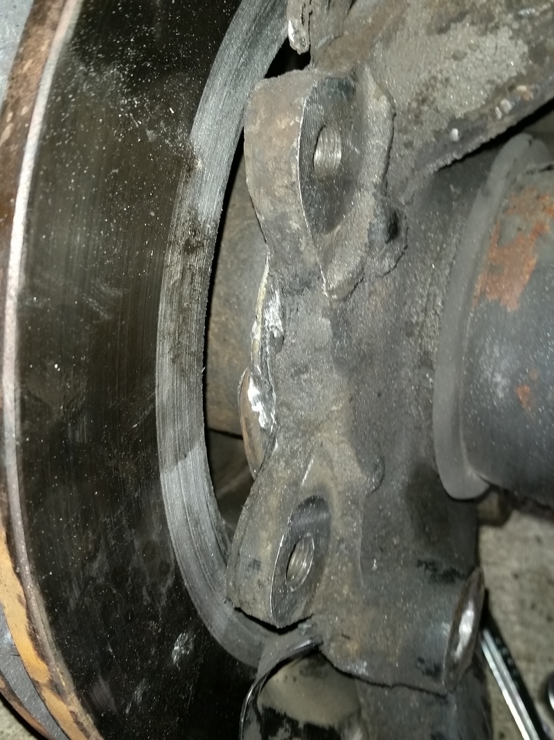

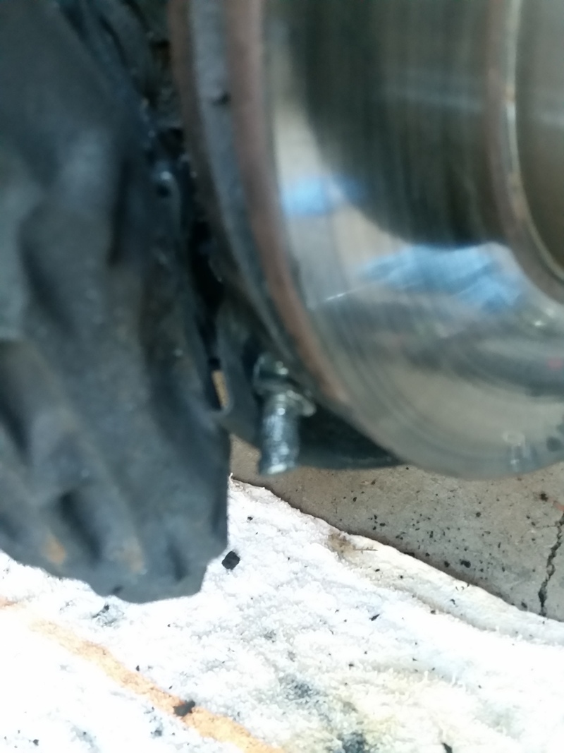

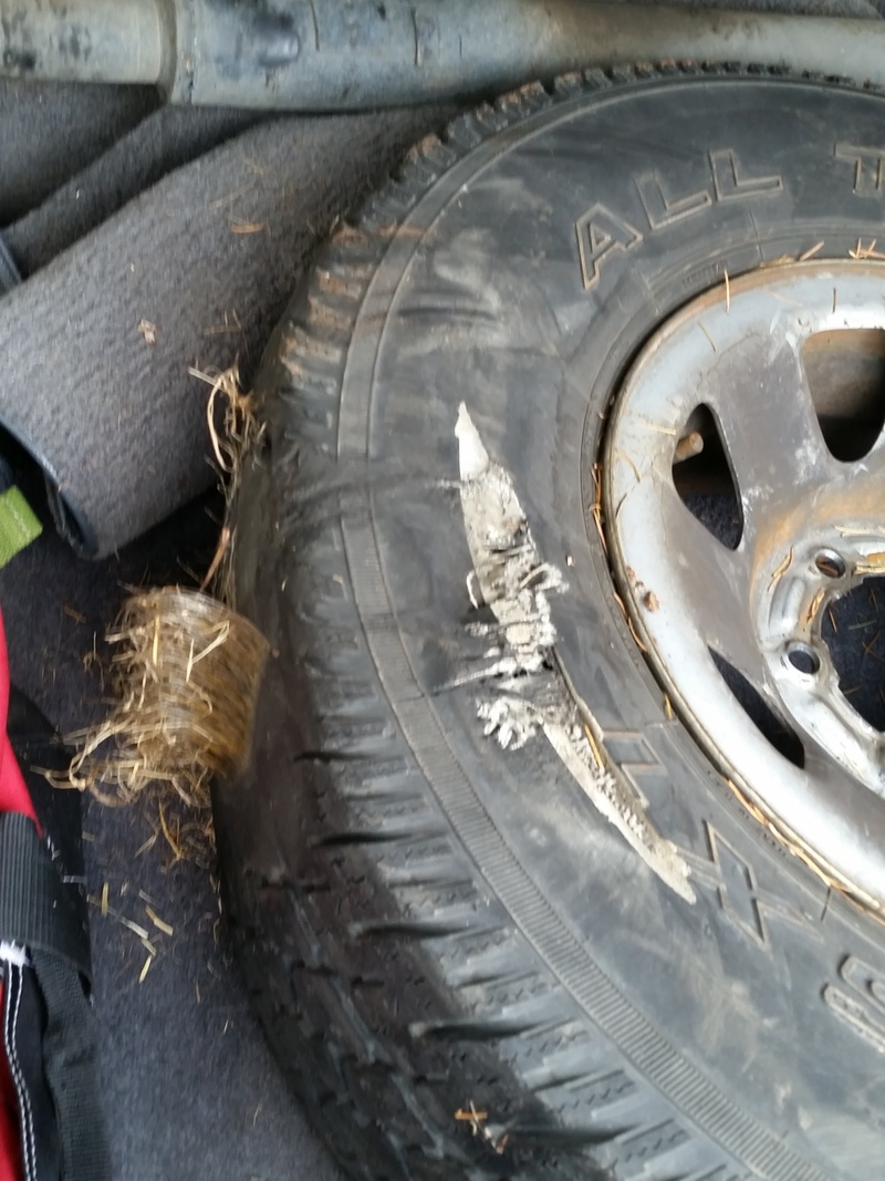

maybe a rock stuck between the backing plate and grinding on the rotor
i got my 4Runner for $400 after a family member had no frigging clue how to do brakes.
said family member was driving happily along when the right front wheel locked up causing this
I started the tear down and found this
bolts jammed between the caliper and rotor
a similar noise to what you described was heard before the tire locked up

Yepp.
​​​​​​That thar is a bolt right off of the disc shield. There's a trillion of them on there so I don't think I'll worry about it until I do spindle bushings.
Fortunately in my case it caused zero damage. Seems I caught it earlier.
Those little bolts are so easy to strip. I remember now that I partly stripped one of them, but it tightened still so I rolled with it. Lesson to be learned, if you strip one of those it will fall out.
