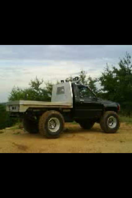

I've got a 1990 4x4 pickup. It has a wooden bed, but it's seeing it's age and I don't really like the design of it. The person who made it did a good job, it even has the original tail lights in their original locations, and a tail gate. I'd like to replace it with a bed like I've drawn up below. I remember in high school, one teacher had a Toyota or Nissan truck with a similar bed. I always liked it. I just wondered if anyone has any photos or anything of a bed like this. I haven't been able to find anything online.
Thanks,
Josh

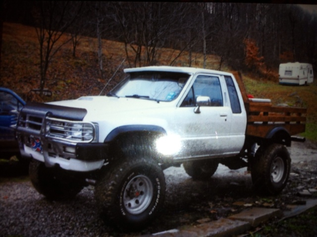

heres a pic of my 1985 before i put a 2wd bed on it form junkyard
Attached Thumbnails Wood bed photos/design-526670_468217699886580_817288822_n.jpg

Sweet! How did the truck ride with that wood bed? Was it heavy enough the rear end didn't jump around? Thanks
Old Jan 5, 2013 | 11:04 PM
evan711's Avatar
Joined: Nov 2012
Posts: 55
From: Stevens county, washington
its decently heavy it rode good the base of it was 4x4's the bottom was 2x6's and the sides and front were 2x10's, probably weighs as much as a stock bed.

My 84... I built this bed for under 200.00 then added CJ5 flares and stained then water sealed it.

I used a hole saw and cut out a whole just big enough for my fuel cap to fit in. Then I screwed the factory filler neck to the wooden side. Mine was recessed back so it didn't stick out
