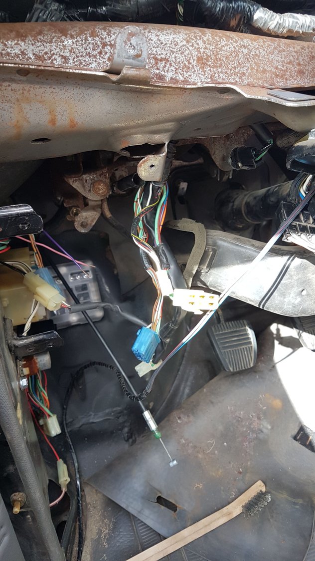

Hey all,
Long time onlooker, first time poster. Have gotten lots of great info from this site in the past!
Lots of blood, sweat and beers have gone into my current truck!
Im currently rebuilding my 22R and converting it to fuel injection.. have complied all the parts from an 1988 4runner(mines an 87 pickup 22R)
but im having trouble identifying a few random connectors.
The connectors are in the steering column area and I believe theyre for the AC that the new wiring harness has but my truck does not have AC.
Just trying to save myself a trip to Toyota to go through a wiring diagram!!
Can someone help ID!
Thanks in advance!
Pic for attention
These little devils

I don't think AC. Maybe for power mirror and cruise switch? The harness is out of a 4Runner if I read your post correctly?
The cowl wiring harness would vary if the truck had cruise control or the power package(lighting, mirrors, etc) but with/without AC didn't make any difference. In that regard the harness was the same.

cheers bud. Yea its out of a 4runner. That makes sense about the power options. When I did a bit of research one picture of an exploded view of control modules, the AC cpu was in that general area. Which led me to believe AC but thanks for the info
