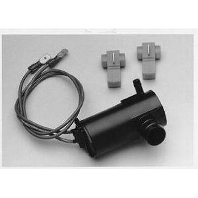

From: Deming,NM
If it looks like this you can get it at Autozone or O'reillys
