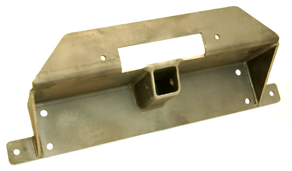

1979-1995 4RUNNER/PICKUP BUMPERS
Front Bumper Winch Mount - $129
If your looking at building your own front bumper this mount makes a great starting point. This winch mount bolts on to the six factory holes found on 1984-1988 Pickups and 1984-1989 4unners. 1984-1985 body style requires drilling two additional holes in plate. Made from 1/4" plate steel. Two inch receiver tubing is also included. Plate is pre drilled for 5000-9500 low profile winches. Also includes holes for 9.0R Warn competition winch. Designed for use with steel or aluminum hawse fairlead. When building bumper, additional mounting points from bumper to frame are required if used for heavy winching. If using a winch with an integrated solenoid, such as the Warn 9500, trimming of the front plastic grill will be necessary. Unpainted finish.
Heres a cheaper one made by Wab Fab. CLICK LINK BELOW
http://www.wabfab.org/products/bumpers/bumpers.htm
