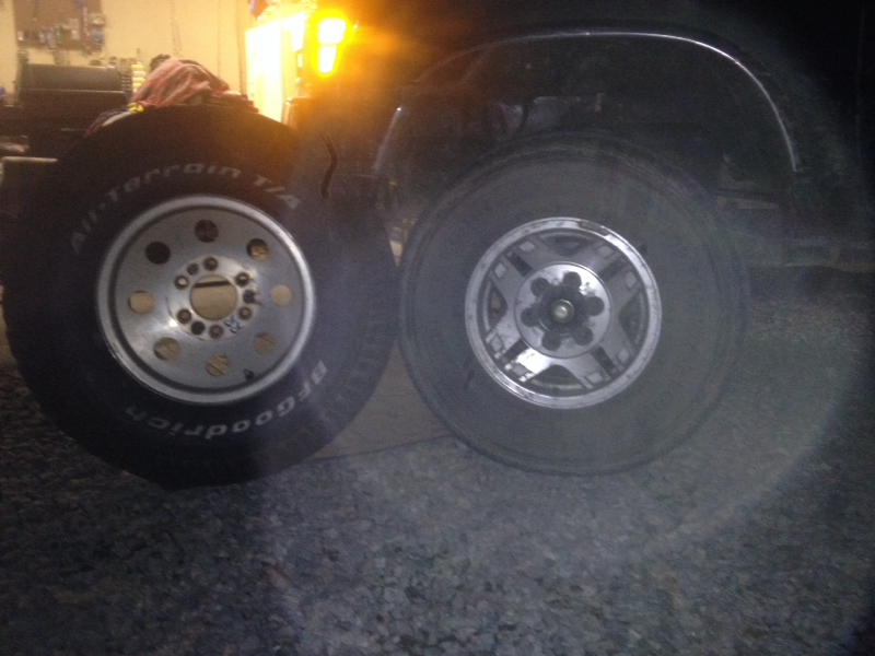

This is what i have

Old 05-14-2014, 11:07 PM
Fossilized
Staff
iTrader: (6)
dropzone's Avatar
Join Date: Oct 2005
Location: PNW
Posts: 19,771
Received 448 Likes on 293 Posts
jack and a lug wrench will confirm or deny...

Red face
If your going to have any issues itwill be on the front so put one one the front axle.
Sometimes the back spacing is not enough and when torqued down the wheel is pulled against the caliper unable to move.

I've got mid 80's Chevy rally wheels on my truck. Had to grind out the centers to fit over the hubs. Wasn't a big deal and the lugnuts align the wheels fine. My truck has sfa, not sure about the backspacing on an ifs truck.
