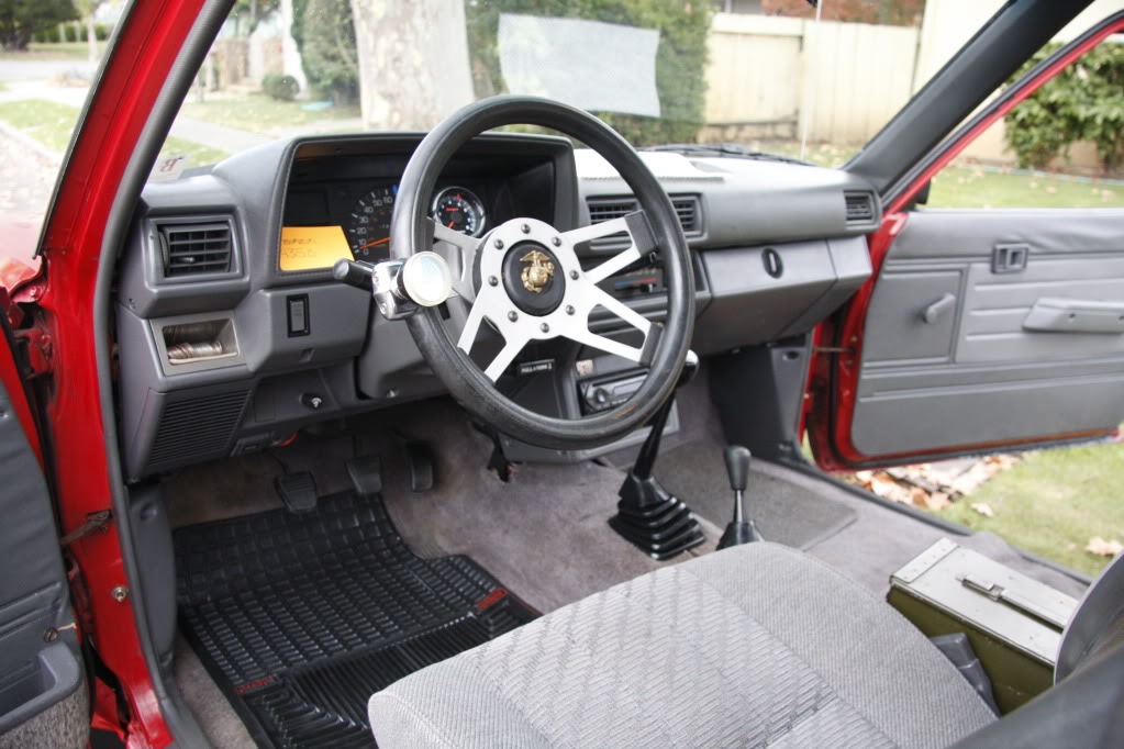

These are from a 4 runner, fit good
say hello to the cat too

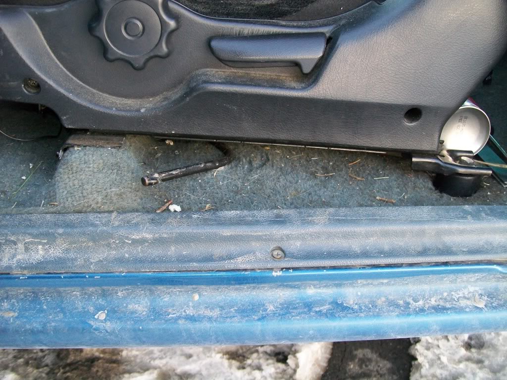

well here is my seats and how i installed them if you have any questions or want any more pics just ask and i'll be more than happy to post them,sorry my truck usually is not this dirty but it's winter and it's hard to keep clean
Originally Posted by rhill
hey weeman, what year is your truck? any pics of those prelude seats??
here they are already in

the seat rails

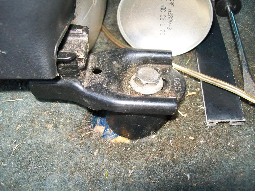

and here is where the honda seat buckle bolted up,i just replaced it with mine

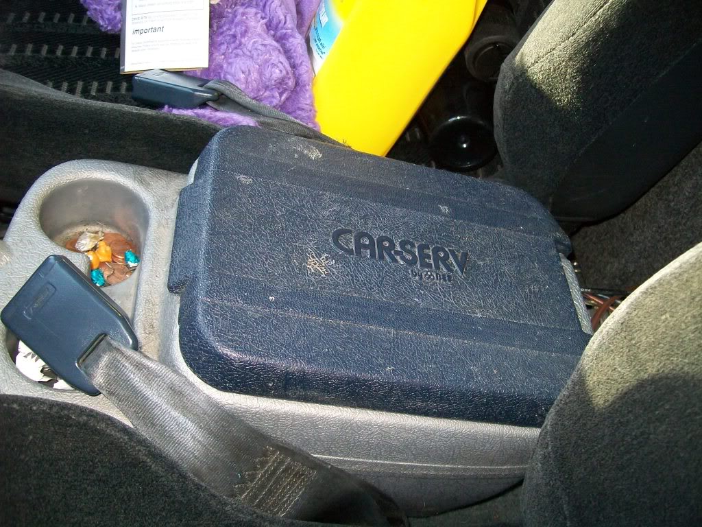

and this is my temporary center console thinkin about getting one out of a 4runner
