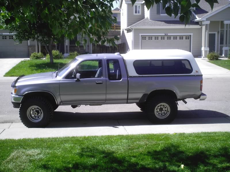

I ran 33x12.50 BFG MT on 15x8 with 1.5" t-bar crank and 2" block and had no prob just pounded down the pinch weld and took off my lower valance

Old 04-06-2008, 08:49 PM
norcalsvx's Avatar
Join Date: Aug 2006
Location: GRASS valley, CA
Posts: 2,122
Received 2 Likes on 2 Posts
you might as well get some used 31's and start saving for a sas and bigger tires 33x12.50's would be weak on a sas

Originally Posted by norcalsvx
I'm pretty sure the pic you have is a 33x12.5 on a 15x6 wheel since its a steelie but I could be wrong there.
Anyway, to answer the question of whether or not the 12.5's will fit on a stock wheel: Yes they will, but the center of the tread will wear out a little faster than if you were to run a 15x8. Some people like to think that the 15x7 would be better for airing down purposes also. Another thing to consider is that a lot of tire shops wont mount the 33's on the stock wheels unless you take the wheels off the truck and bring them there.
