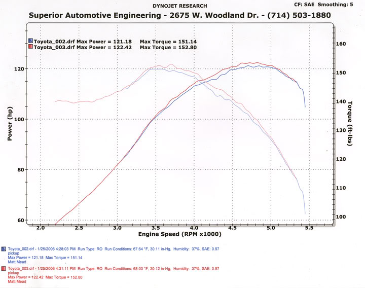

Add in a driveline that eats up 1/3 of the power
Which is why the dyno 120whp...
1/3 of 120 is 90. If you wanna use the % scale to show drivetrain loss. 78-80% of 150 is 120. Which is where most descent, modern automatic transmissions fall. They're not 30% anymore.
