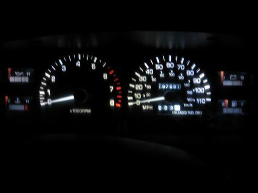

my 95 4-runner with white led's four 194 leds and two #74's

yours came out way better than mine, and mine is basically the same as yours, how did you get the light to spread so well?

i ordered the leds from superbrightleds.com and there the 5 led bulbs. the way they build these leds suppost to give more lights to the side.
{5-LED super wide angle 194/168 wedge base bulbs
4 radially mounted 3mm LEDs emit most of the light from the sides of the bulbs
1 High Flux LED emits from the end of the bulbs - non-polarized bulbs }
they work really well as you can see from the picture... plus they shipped if fast and there pricing is great!!
