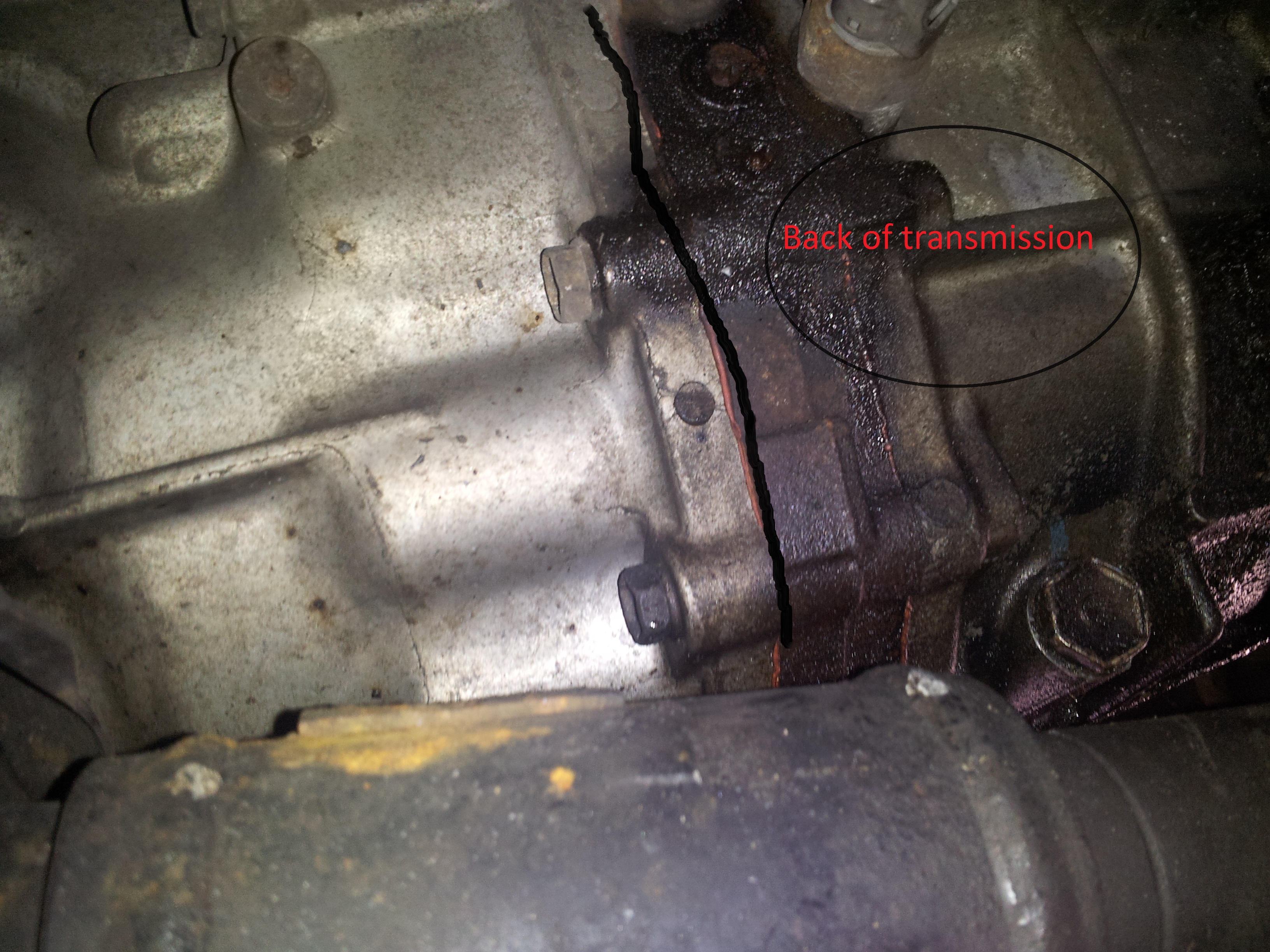

Traditionally (based off the haynes book) the plug should be at the bottom with a bolt in place clear as day.
The arrow where I THINK is the plug is a (I believe) 22mm bolt. Is this right? Any clues?
Attached Thumbnails Where is this transmission plug? (pics)-20130331_110421.jpg

Sorry, just assumed everyone knew I meant the drain plug. It's SUPPOSED to be on a 6 cylinder 4wd 94' 4runner (I suspect this isn't the original transmission). Manual.

Thats the drain plug. The fill plug is up above that one. Same idea as the differentials.
I think thats what your asking And from what you have shown thats an R150F trans which is the correct trans for your 4wd 3.0 4runner.

Probably goina have arguers about this saying oh its an R151F. So heres your link.
http://en.wikipedia.org/wiki/Toyota_R_transmission

Yeah, that's what I was askin about... good to know its the original too (and not good lol). So 21-22MM bolt sounds right? I just thought it was odd. Like I said, in the haynes book it had a picture underneath showing the bolt directly on the bottom of the transmission for a 4wd version. I tried to loosen it up before posting but it was pretty firm and I didn't want to screw with something that might have a very negative effect.
