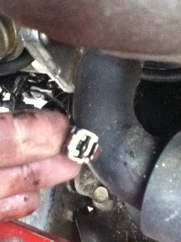

Took of the intake and put it back on, no engine won't crank. Found a gas leak but it should still try to start, right? Anyways I also found this stray plug hanging down, any idea where it goes? I hangs down on the passenger side of the motor near the starter

OP sender?Starter?Knock sensor?Fuel Injector?

All of the injectors are plugged up, knock sensor uses a different plug, gonna check the starter later, I got mad at it and had to go to class for the night

Looks like the starter signal wire

Would that cause nothing to happen would I turn the key?

Yea there should be a place for it to clip in on your starter. When you turn the key that wire signals the starter to turn over.

yep .. starter sig wire

Awesome, thanks guys...now to fix the fuel line. Yay
