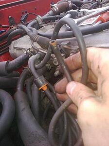

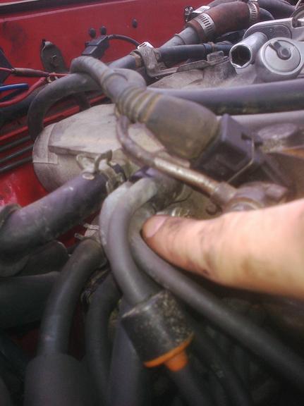

I'm just at the tail end of dropping a new engine in and I took photos but apparently missed this one;
in the pictures below anyone know where this hose goes to??
Where does this hose go?! 1992 Toyota Pickup 4x4-8syyb.jpg Where does this hose go?! 1992 Toyota Pickup 4x4-ajxae.jpg

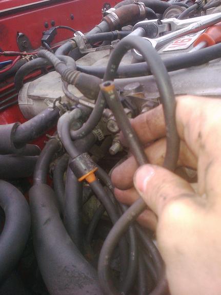

I THINK it came from somewhere around here.
Thanks for any advice!
Dean

Just under the plenum to the left of where your hose comes out there should be a row of 4 vacuum hoses. I believe yours is the 4th or the one closest to the firewall.

The picture is kind of blurry...what number or symbol is on the hose? If you've been going by those, i can post a picture of mine so you know where it belongs.

Is that hose labled #2? if so, hose #2 goes to passenger side of center VSV mounted on on the top of the passenger fender well.

The symbol is "*#"
Is it ON the plennum because I have the old one as well I can upload a picture for better view

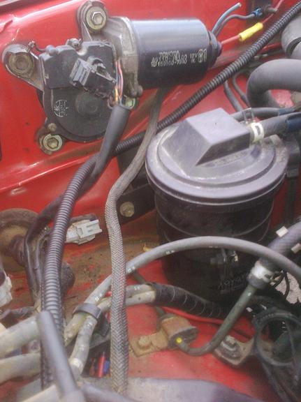

I called that "3/*" in my labeling. Here's a picture of where it was on mine...

you know what, I think my buddy was looking at the plennum we took off and must have mixed wires. This helps a tonne, I'll have to double check the vacuum guide.

Do you have a picture of the fender wall where they go in as well? I'm trying to sync up all the cabling and not sure if im following the guides I have correctly.

I didn't take a picture of that side because I didn't unplug anything from the other end but it looks like those 3 go to the VSV. I attached the relevant page from the FSM. Hope that helps!
