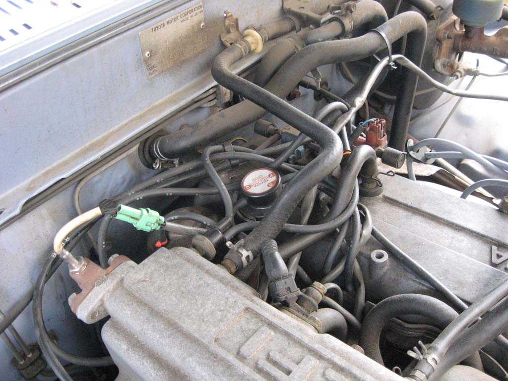

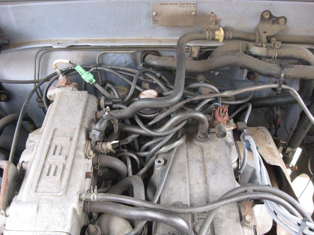

Here is how my 88 is setup.

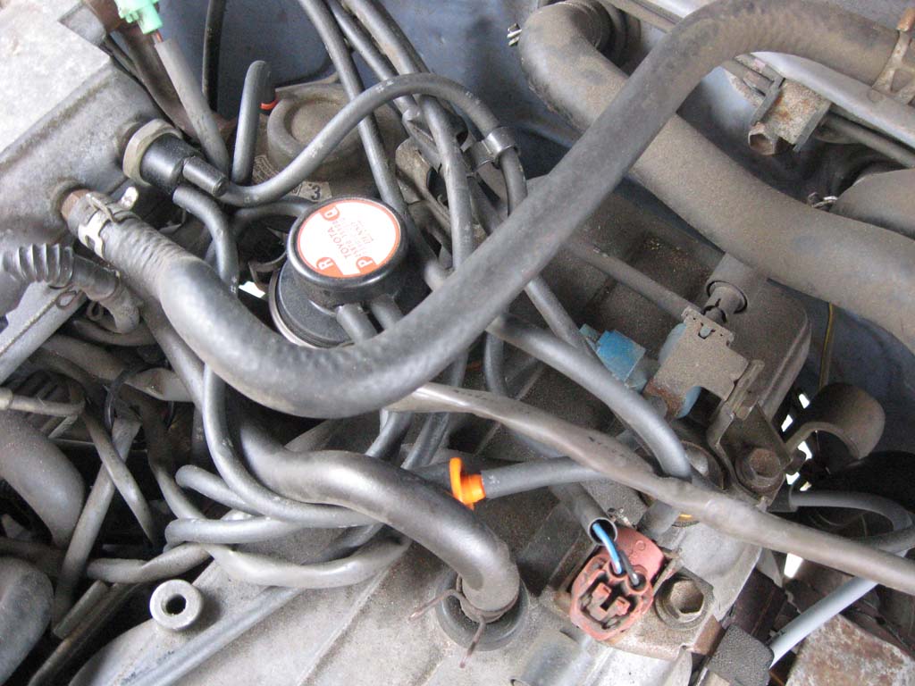

Jeebus. Takes me long enough!
The white plug is for an idle up VSV that I apparently don't have, A/C or PS. When I put my motor in forever ago, the disassembly had been done without me, and so it was just matching plugs to everything. Years of laying in the heat kind of trained mine, so they all laid out pretty close to where they went.
