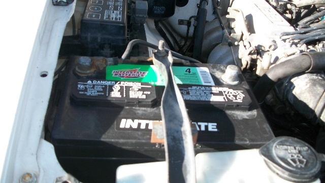

under the hood rectangle box 2"X1" plastic mounted on the side of fuse / relay box about a foot behind the battery, could be black, could be tan. flips up from the front I believe.. doing timing??
J
The little tan box behind the Interstate battery top of picture, 2 pins inside to be shorted to set timing

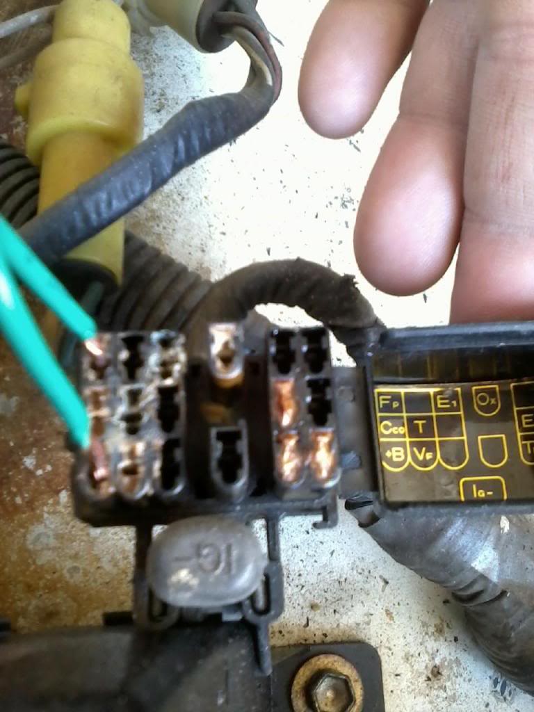

The Diagnostic port for the 85-86 is on the Drivers side inner fender and is nothing the same as the 87 and up. Here is T1 and E1 jumped. The codes and engine flashes are the same as the rest of the trucks on the dash.

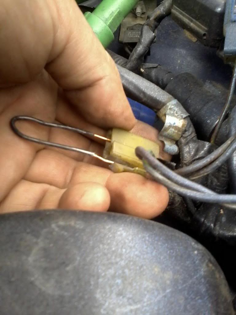

Here is how you do a Fuel Pump Bypass on the 85/86.
Jumper wire the Yellow Plug on Drivers side. ( Jumper wire should be in both contacts for testing, I just didnt have it in for picture purposes and mostly a referece for me at a later time.)

My 91 looks exactly like that, loaded with dielectric grease and everything, but no rusted fender well, no rust to speak of as it's a San Diego truck. Is all that red the mud I saw everywhere as I crossed the middle area of the US, Missouri, I-44 area just before 9/11??

We have red mud everywhere. I drive I 44 everyday and if you get off of it and on the side roads it is easily found. It can be a pain to get off of trucks as it gets gummy.

so I appears it is the smaller one that pulgs into rubber boot in the inner fender , his 86 doesnt have the small box by the fuse box like my 90 does, Thanks Dean
