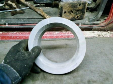

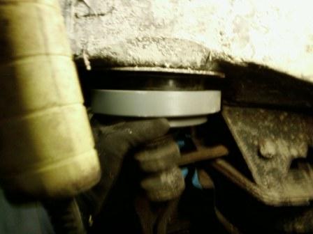

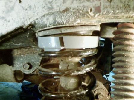

So here is some pics. You'll notice the spacer does not sit flush w/ the frame.
Also the end result.
Attached Thumbnails When new Coil Spacers go bad!-0211081534.jpg   When new Coil Spacers go bad!-0211081535.jpg   When new Coil Spacers go bad!-0211081536.jpg

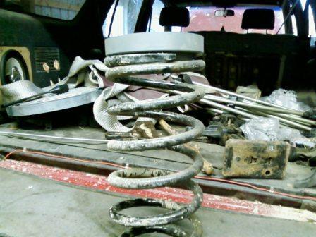

and some more pics. The last one is how it sits w/o the spacers.
Attached Thumbnails When new Coil Spacers go bad!-0211081537.jpg   When new Coil Spacers go bad!-0211081537a.jpg   When new Coil Spacers go bad!-0211081538.jpg

are you trying to shove the spacer on OVER the rubber cone in all those pics? or just the last.... is it broke in the last?

oops! This is how it sits w/o spacers.

hmmm.... so it looks like really, you should get better spacers, or have them modified... if they are cracked damaged, they should be tossed/replaced, if you dont like either of those options, you should either (A) cut all but 3/4" of the cone off with a saw (hand saw) and then install -Frame-Spacer-rubber-spring- or better yet leave out rubber all together.

in the second pic of the first post of the pics, what is there... and also in the third of that same post
Old Feb 11, 2008 | 06:20 PM
90T4R's Avatar
Joined: Jan 2008
Posts: 37
From: Philly, Pa.
The second pic is me holding the spacer in place by hand. The third pic is the spring and spacer installed. The spacer is supposed to sit flush w/ the frame. The spacer split when I put up pressure on the spring (jack under the lower jshock mount). Even after it broke it still doesn't sit flush w/ the frame.

in the third picture it looks like it, but in second is the rubber also between frame and spring?
Old Feb 12, 2008 | 02:41 AM
90T4R's Avatar
Joined: Jan 2008
Posts: 37
From: Philly, Pa.
Yes it is. I know I don't need it but again the rubber is not the issue. Either my seat is outta whack or the inside Dia. of the spacer is off. Which is my thought.
