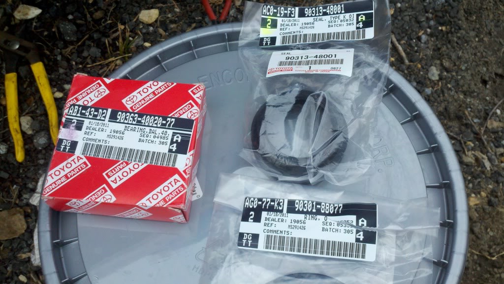

Old Sep 5, 2012 | 07:29 PM
TNRabbit's Avatar
Joined: Apr 2006
Posts: 4,787
Likes: 36
From: TENN Native Languishing in Virginia
Old Sep 5, 2012 | 09:34 PM
Grego92's Avatar
iTrader: (4)
Joined: May 2010
Posts: 720
Likes: 16
From: People's Republic of California

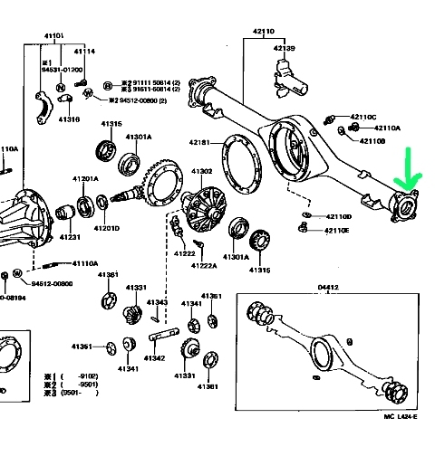

Not exactly sure what seal you already replaced, but I believe there are two seals and the o-ring that could be replaced if you were to remove the axle.
This is for a 92' pickup so yours may differ:
42311A - Part No. 90310-50006 in the diagram is a seal that is tapped into the axle housing (green arrow area in second picture). I think this is sometimes referred to as the inner seal.
42311E - Part No. 90313-48001 in the diagram (and in TNRabbits photo) is known as the outer seal.

I just did a differential leak repair and drum brake job, and purchased both of the above mentioned seals to do some preventive maintenance while I was in there. Luckily my o-rings were fine because I forgot to purchase those. I only replaced the inner seal because to get to the outer seal it required some press work from a shop.
If it's the inner seal that is leaking, did you use oem seals from the dealer? did you put some grease around it to help tap it in and so it goes in straight and flush? I admittedly screwed one up while tapping it in, and had to run to the dealership to get another one.
