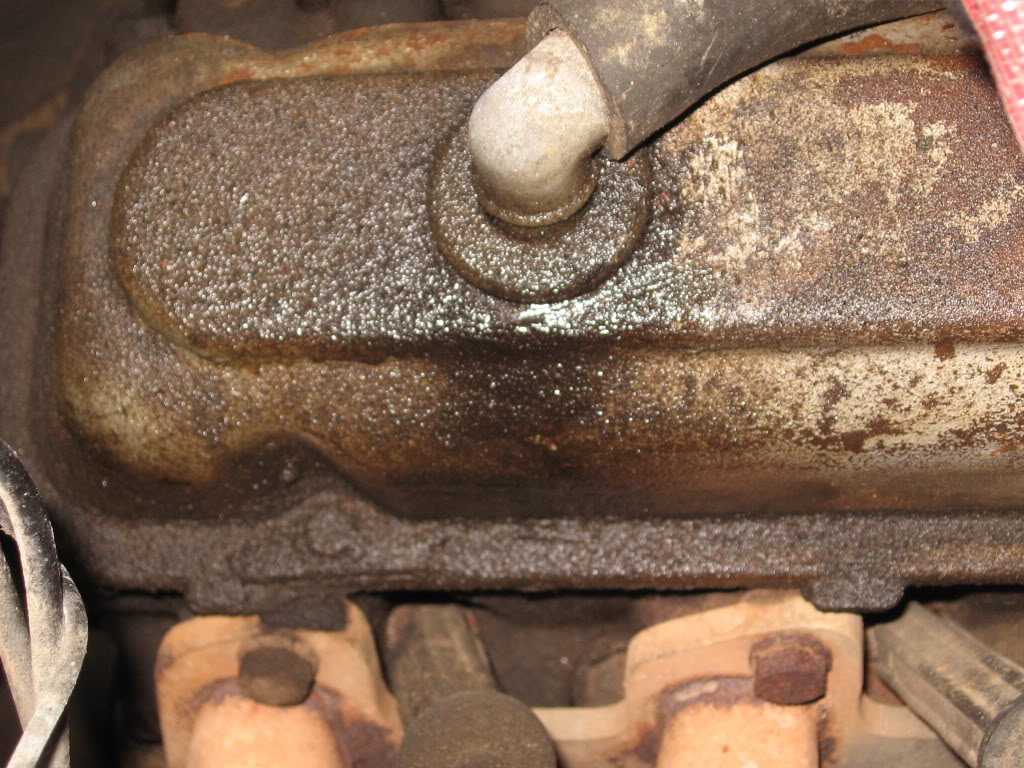

I dnot think the other valve cover has a vent..i'll snap some pictures real quik
Old Nov 12, 2007 | 12:28 PM
  #33
Tacoma750's Avatar
Joined: Oct 2004
Posts: 1,230
Here is a shot of the passenger valve cover....no PCV valve or vent.
OO and i lied..there is a valve on the driverside
Old Nov 12, 2007 | 01:21 PM
  #34
rowdy235's Avatar
Joined: Sep 2007
Posts: 1,803
From: Sweet Home, OR
On my 22r, there are two places on the intake. One is the PCV and runs into the intake, leave that one if possible. The other one runs from the VC to the top of the air filter. That one you can just put a small cartridge filter on and call it good.

You see all that oil on my valve covers? What the heck is that from? I just cleaned them maybe two weeks ago
