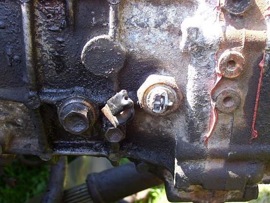

Can anyone tell me what this plug is for? Its on the drivers side of a w56 tranny. Just put the tranny in the truck and must have snapped it off in the process.

i can't say for sure, but it might be for the back up lights.

http://www.ncttora.com/fsm/87-4Runner/87_W_Series.pdf page 3, its's the backup light switch pricey little bugger too: 84210‑60021 $37.41 at toyotapartszone.com plus shipping
or Autozone's $24.99 http://www.autozone.com/autozone/cat...&parentId=57-0
