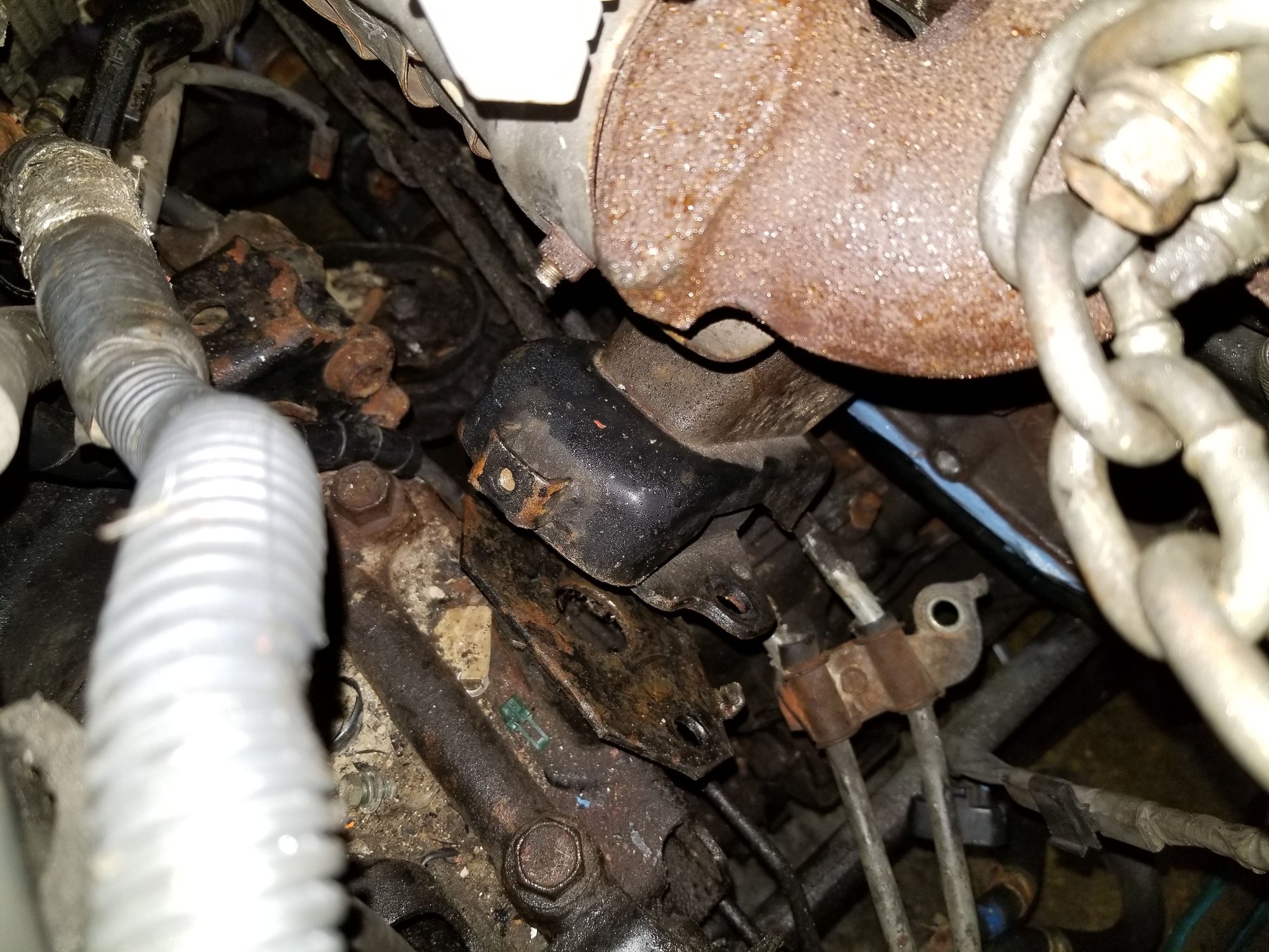

I'm in the same situation right now. i went into this expecting it to be a couple day job. MANY HOURS LATER! i have the motor bolted to the tranny but the mounts are not lining up. I have both 3.4 and 3.0 mounts in my possession . i used the entire mount of the 3.0 including the part that bolts to the block. Was i just supposed to use the 3.0 lower rubber mount? and attach that to the 3.4 piece that bolts to the block?

With no clue just what your working on pretty hard to answer questions
Manual or Auto did you start with a 3.0 or 22R series??
It can take days just getting all the codes to clear
Not enough research ??
Pictures of what you have would be great .
Don`t line up by how much several inches ??

Wow i appricate the quick response! I have a 1992 4runner auto with a 3.0 and Im putting a 3.4 that I got from jdm depot in New Jersey so idk what it came from so the harness is gonna be a nightmare. But i have full mounts off the 3.4 just dont know if I was supposed to just use the bottom half because it's not lining up. I'm at work now I can provide pics later. But there off by about 2-3 inches.

For what it is worth
I always bolt the lower part of the engine mount to the frame first
The upper part to the block then line things up.
**I need to look you might have the mounts on back wards like the right and left sides swapped ***
***You need access to be able to bolt the upper and lower mount together from the outside of the block ****
Like I said is the transmission keeping the engine from coming far enough front.
Maybe the Crossover pipe just how did you make yours

Do u use the 3.0 bottom half? And i dont have a crossover pipe on right now. Plan on dumping both pipes down.
