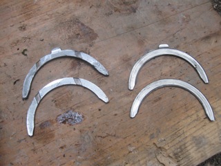

Well my truck lasted till the end of school. driving home on grad night it started to lose power and started making the classic rod bearing knock.

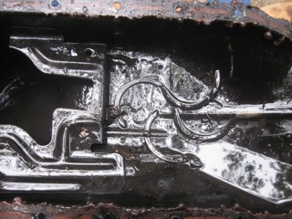

Dropped the front diferential today and pulled the oil pan in order to change the rod bearings. while digging through the silvery gunk that was left in the pan i found these. any idea what they are? or how screwed my engine is?

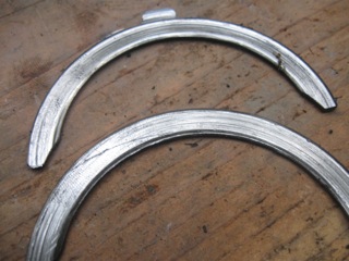

here they are clean

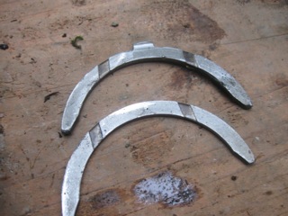

the first pair
Old Jun 18, 2010 | 08:12 PM
iPirate's Avatar
Joined: Jan 2010
Posts: 9
here's the other pair

almost want to say a ring

Oof! Looks like thrust washer/s to me.
See if you can man handle the crank back and forth. Sorry- bad joke. Seriously though....

The engine may be ok in the cylinders... the crank is gonna need to be turned and polished at the least if it moved a bunch!
Not a good scenario there man....
Might look into full rebuild. That isn't a cheap fix.
How many miles on the thing now? They typically don't just fall out, what hapened exactly?
Yeah... the crank might be salvagable. Only way to tell is look at it. Did the engine sieze?
Hard to tell what shape the engine is in from oil pan pics. Sorry.

Those fell out on their own???? Man I hope your crank is still savable

I had a set fall out once, but it was helped by a 3200lb pressure plate.
Years of abuse and improper oiling can wear them down (notice the score marks) can cause them to slip out under certain conditions.
You need to pull the crank out, and examine the block and crank surfaces between the thrust washer locations. A machine shop might be able to polish them, but chances are you'll be looking for a new block/crank.

the first pair look really worn, while the second are just bent. if i remember right, the lobes on the crankshaft look kinda like the first pair. i'll go look again in the morning.
