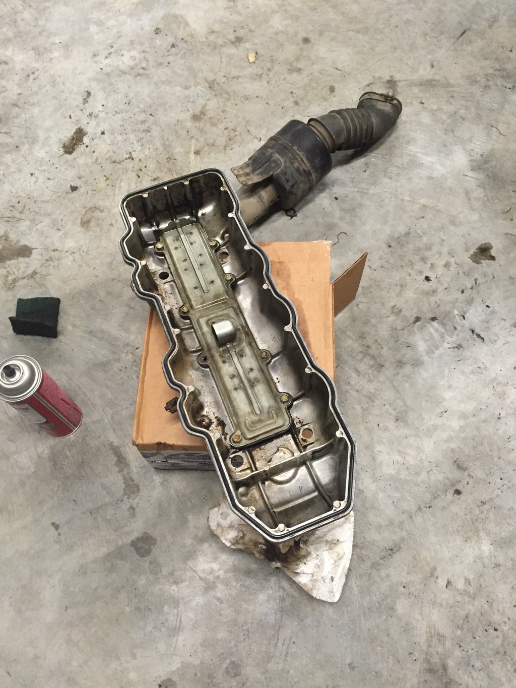

it's bolted on .. just undo the bolts

wow that's cool. However all three of mine are riveted.

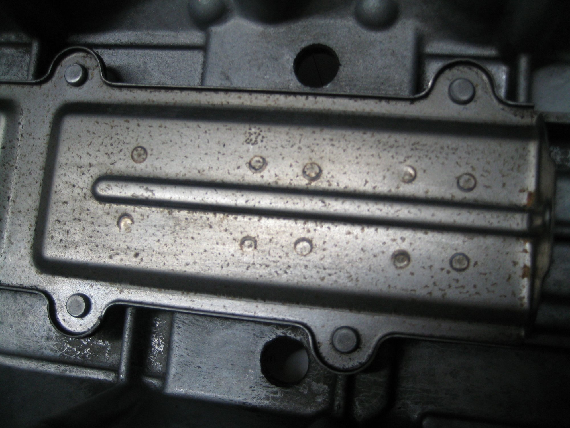

this is what all mine look like
Old May 6, 2015 | 04:25 PM
slacker's Avatar
Joined: Jan 2006
Posts: 6,384
Likes: 304
From: BC Canada
so why do you want to take the plate off ? you really don't ever have to remove this , unless your sandblasting the cover or something like that ..
Old May 6, 2015 | 04:45 PM
ditypup's Avatar
Joined: Aug 2014
Posts: 103
From: CO
If a person could replace the gasket easily then why not? But, evidently that is not the case for my covers. Wonder why Toyota made covers with removable PVC baffles and some without. Maybe it was a production and cost thing, who knows. At least now I know what the extra gaskets are for. ;-)
