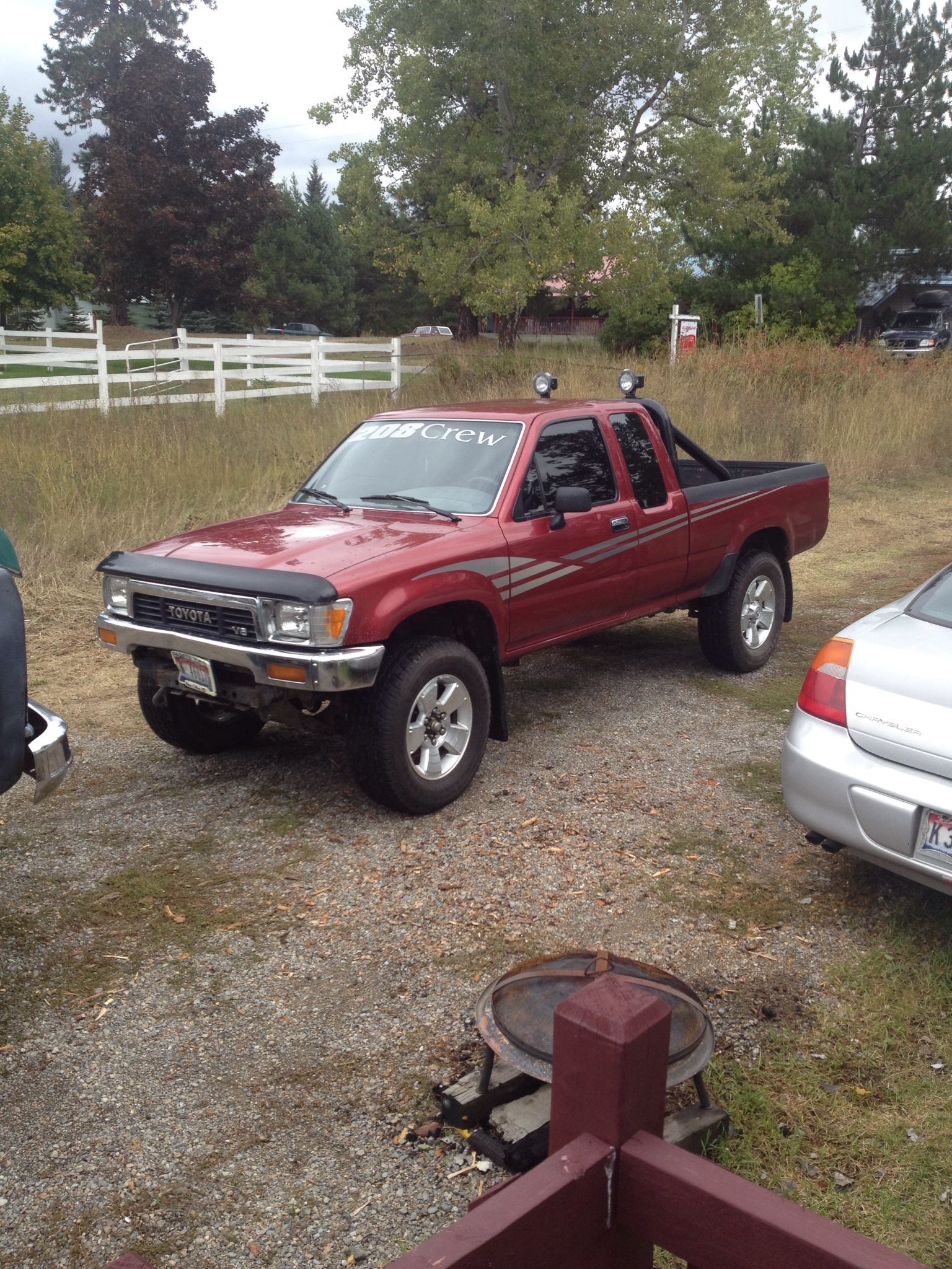

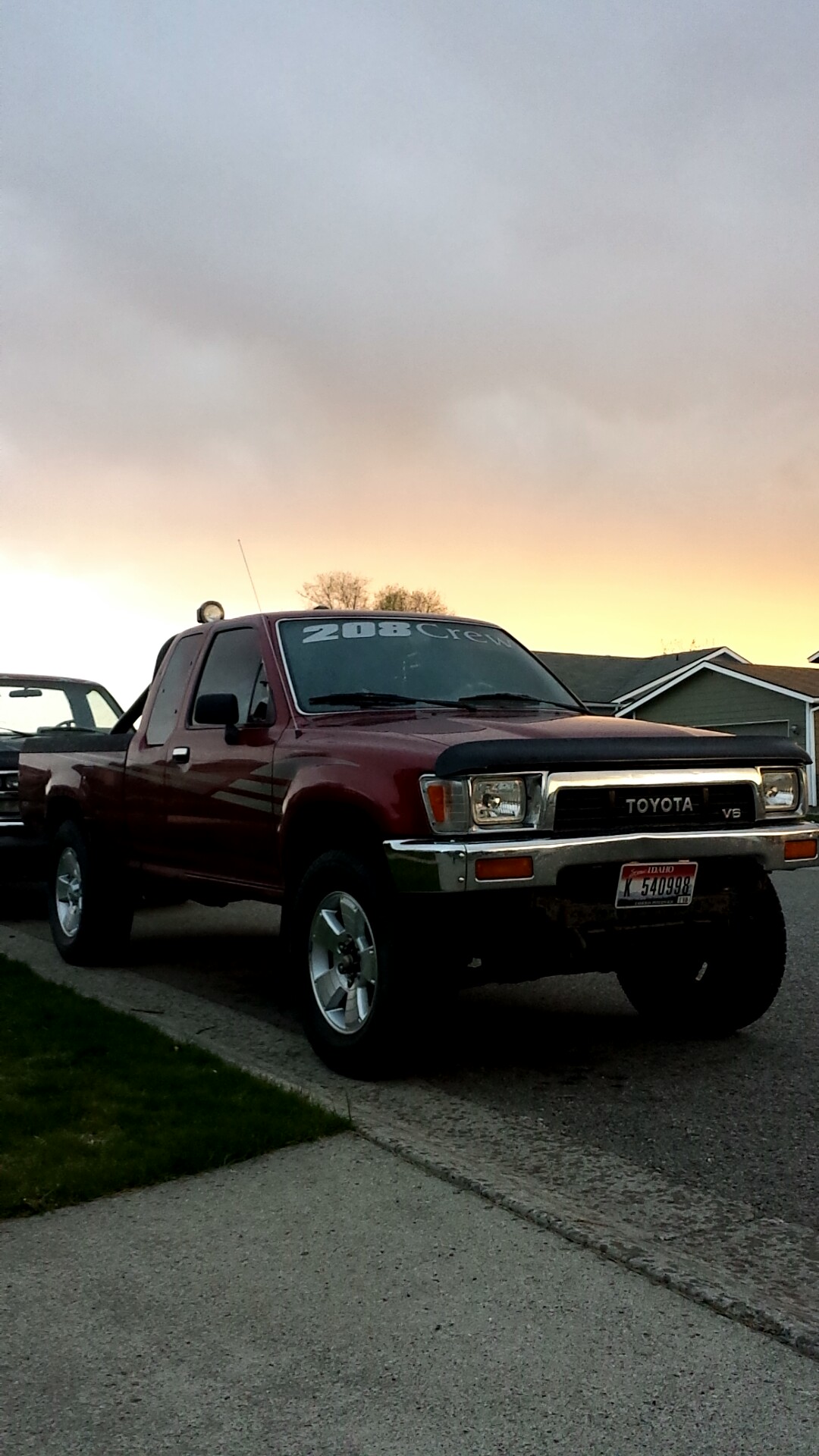

So right now im running 17" wheels with 265 tires which I think is the equivalent to 31's. I want to get some smaller, deep dish wheels so my tires will stick out more and I'm getting 12.50's for the width. I really want to get 33's but I don't think that they will fit my truck since it's stock with no lift. And I don't want to lift it until I get a SAS instead of my IFS.
So my problem is, my goal tires are 33/12.50's on deep dish wheels...but i don't think they will fit without rubbing? I need tires before winter hits since my current ones are bald. Summer is just starting so I have time to save some money, but I know I won't have enough to get my SAS, 4" lift, and tires before winter. Should I just say screw it and buy 31/12.50's or 32/12.50s? (If even 32's will fit.)

You can fit those but the pinch weld in the back of the front fender could use some persuasion with a BFH.

keep your current wheels, get 1.5" wheel spacers and 305/70R17s or 285s. I have those same wheels but with 37s
