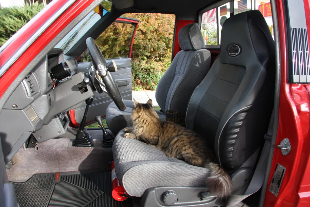

Funny, i noticed my cat and 4 runner when i posted , good catch.
both cats love my truck, i can't keep them out. Name:  IMG_2428.jpg
