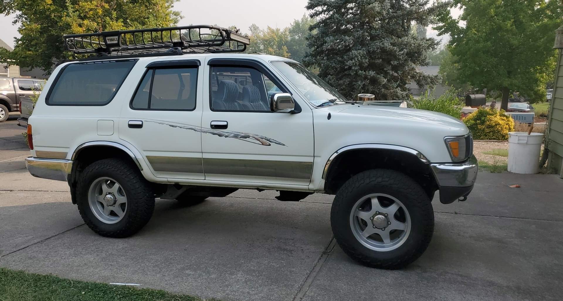

Live in S. Oregon, have a 1991 T4R, 3.0 V6..yada yada yada....
I love this Rig. My 4th Cylinder is going out. I am so freaking pissed that the guy who sold it to me knew, and didn't say a damn word. My daily driver got recalled and I bought this to drive in the interim, and I'm feeling like I wanna keep it but it's going to need a new motor and that is WAY too much money than I have right now (3.4 swap with all the harnesses and wiring...) What the hell should I do?
