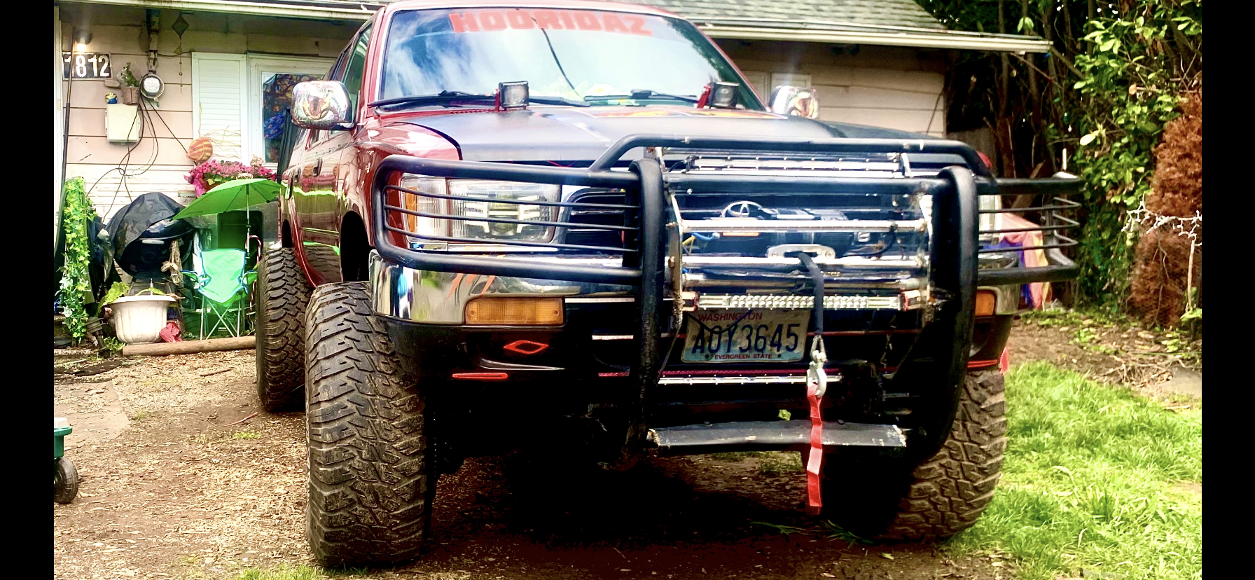

I have a no start issue, after I replaced my fuel pump fuel relay, all injectors and afm-maf unit. It stutters and stumbles yet will not stay lit. I don’t have voltage at my injectors like the CPS is faulty. I do Have spark and timing is right on. My question is… do I replace the dizzy or is it a ecu issue?
