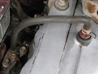

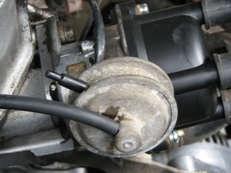

Old Jun 30, 2010 | 01:40 PM
familiesr4ever's Avatar
Joined: May 2010
Posts: 9
Pics1
Pictures
Attached Thumbnails Weber Carb problems - 86 Pickup-img_4449.jpg   Weber Carb problems - 86 Pickup-img_4450.jpg   Weber Carb problems - 86 Pickup-img_4451.jpg

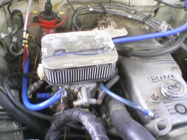

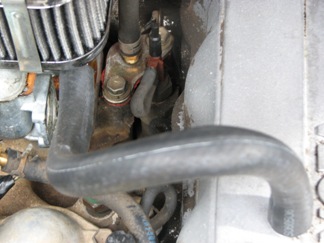

Old Jun 30, 2010 | 01:42 PM
Joined: May 2010
Posts: 9
Pic2
Pictures
Attached Thumbnails Weber Carb problems - 86 Pickup-img_4452.jpg   Weber Carb problems - 86 Pickup-img_4452a.jpg   Weber Carb problems - 86 Pickup-img_4453.jpg
Old Jun 30, 2010 | 02:07 PM
xxxtreme22r's Avatar
Joined: Aug 2009
Posts: 13,574
Likes: 72
From: Wilkes-Barre, PA, USA
everything looks as though it should, however, I am curious as to what you did with the vacuum rail that runs along the valve cover. Although I did notice you don't have a power wire going to the idle shut-off solenoid.
