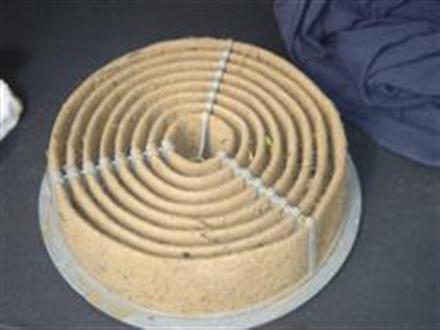

yea I open the air box and this is what I saw

well i went out today and bought a K&N filter and now it starts up much easier
