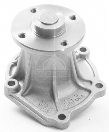

What do you mean by waterpump pulley? People don't just replace the pulley when it goes bad... they replace the whole waterpump, and waterpumps sell for less than $100. Are you sure you have the terminology correct?

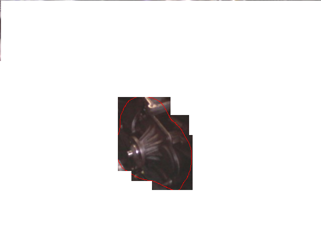

The part that bolts and covers the water pump, were the belts go on, it is pretty much a piece of metal that just covers the water pump and the belts go on the pully attached to it. My berrings froze up and it ripped it apart.

Here is a picturer of it on my rig...all frozen up
I cant even move it with everything off it. I wound a bering "piece" in my skid plate
sorry it is kinda small, this site wont load the whole pic, so i had to cut to size, but this is it still on the rig over the water pump, i took off the pully connected to it

I got a water pump, but that isn't the problem, the pully housing over it, a whole different part...is like wheres waldo where i am at. that is the problem cause the berrings that let the pully spin are gone, grinded up, and nobody sells them except the stealership.

That's funny stuff....that thing definitely looks like a water pump when you don't know what's behind it and are not familiar with these motors. I just took mine apart and when I unbolted the bracket I was like...huh...nothin but an idler bracket.

As described above by RC000E - the part we're discussing is a cover bracket with idler and fan pulleys. The only thing it does for the water pump is serve as a dust cover. It's crazy that YO wants so much money for them.
