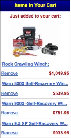

prices from 500-1050 on a warn winch
I called winch depot and had a chat, he recommended that the winch be about double the weight of the loaded vehicle. I haven't weighed it yet but checking other 2nd gen weight posts shows that they're really close to 4000lbs when loaded. Of the 4 that fit the t-15 they range in price from 539-1049. would the 9000, 9.5xp or 9.0rc have any benefits that would justify the extra $ or should I just shut up and get the 8000 already? I am happy at least the choice is down to these 4, I gave up on MM after reading all the torture tests and other reviews here and on pirate etc.
